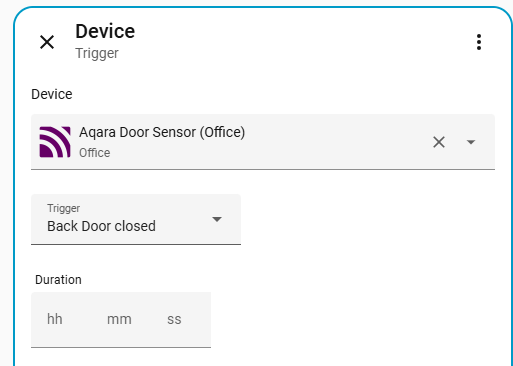

this is the yaml for the “door closed” notification
alias: Rear door closed notification
description: ""
triggers:
  - type: not_opened
    device_id: a3f0a8d3339f29c2a73bc73ed57dd28c
    entity_id: 5444386840f4fcfc01788a085b9731c7
    domain: binary_sensor
    trigger: device
conditions: []
actions:
  - action: notify.mobile_app_simons_iphone
    metadata: {}
      message: Office Back Door  was closed.
      title: My Home
    alias: Send notification to Simons phone
mode: single

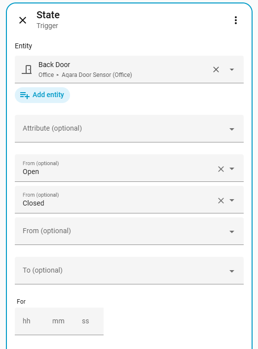

It is because on a restart, the device is shortly unknown. If you use a state trigger instead of a device trigger, you can add a condition
something like this?
Yes, Indeed.

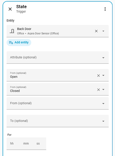

There are also things like this you can do. adapt as needed…
