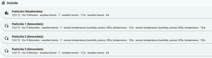

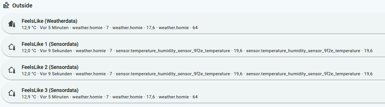

I created four different sensors to test the behaviour, but it seems that none of them result in the missing values being taken from the weather provider.
Here are the results:
and:

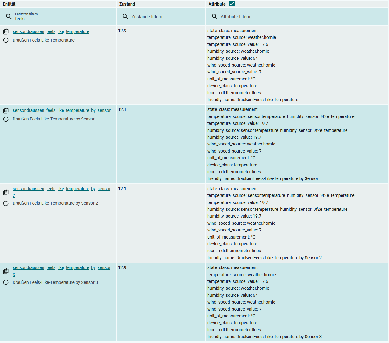

Looks like that:
