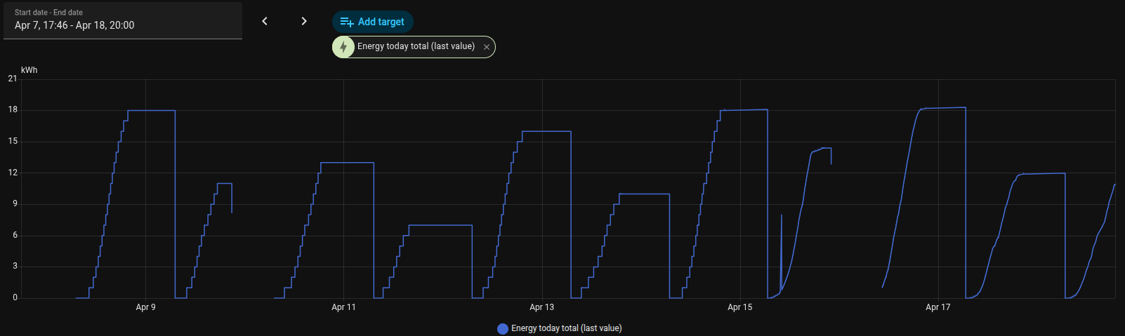

I created this sensor so I can still see the value after it goes offline. This works well.
template:
  - sensor:
      - name: "Energy today total (last value)"
        unit_of_measurement: kWh # it is kW, but I read that I need to enter kWh, otherwise it won’t work?
        device_class: energy
        state_class: total_increasing
        state: >
          {% if states('sensor.goodwe_omvormer_esp8266_energy_today') not in ['unknown', 'unavailable'] %}
            {{ states('sensor.goodwe_omvormer_esp8266_energy_today') }}
          {% else %}
            {{ this.state }}
          {% endif %}
Now I also want a bar chart to show the maximum value per day (over a period of 6 days).
Unfortunately, this doesn’t return anything — what should I do differently?
The history is present, but not in the card.
