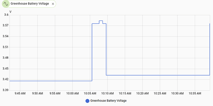

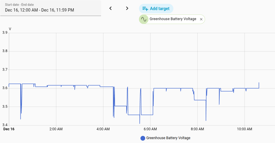

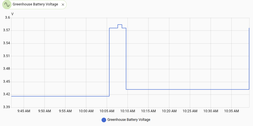

Sensor reading in HA History doesn't match ESP32's serial log
My greenhouse ESP32-S3 is on a deep_sleep cycle of 3 minutes awake (to take 3 readings) then 30 minutes asleep. I am monitoring the battery voltage using a INA3221 so that I can take actions as the battery voltage gets low … but the first battery voltage reading in each cycle is usually low.
In this case the HA History shows the last battery voltage reading of 3.63V at 10:36:22AM and previous at 10:04:44AM.
However the ESP32 USB log (below) shows the ESP32 waking at 2025-12-16 10:36:19.954, and I can see only one Battery Voltage sensor reading being taken at 2025-12-16 10:36:23.610 - with value 3.18400, which is used to shut down the ESP32.
Why do these not match up ? I can understand the clocks on the three computers not being perfectly aligned … but how to explain the difference between 3.6 and 3.184 ???

Now that I’m looking closer, it seems that HA is receiving sensor reading values from INA3221 when it is being initialised as part of the ESPHome boot procedure, but not recorded in the log.
Eg:
Unfortunately you can’t see the individual data points, but they are:
entity_id state last_changed
sensor.greenhouse_battery_voltage 3.41599988937378 2025-12-17T22:42:00.000Z
sensor.greenhouse_battery_voltage unknown 2025-12-17T23:05:33.983Z
sensor.greenhouse_battery_voltage 3.57599997520447 2025-12-17T23:05:36.815Z
sensor.greenhouse_battery_voltage 3.58400011062622 2025-12-17T23:07:36.795Z
sensor.greenhouse_battery_voltage 3.57599997520447 2025-12-17T23:08:36.813Z
sensor.greenhouse_battery_voltage 3.43199992179871 2025-12-17T23:09:36.809Z
Looking at the same period, the ESP32’s serial log includes:
  • [2025-12-18 10:05:32] [C][ina3221:017]: Bus Voltage #3 ‘Battery Voltage’
  • [2025-12-18 10:05:36] [D][sensor:133]: ‘Battery Voltage’: Sending state 3.57600 V with 2 decimals of accuracy
  • [2025-12-18 10:06:36] [D][sensor:133]: ‘Battery Voltage’: Sending state 3.57600 V with 2 decimals of accuracy
  • [2025-12-18 10:07:36] [D][sensor:133]: ‘Battery Voltage’: Sending state 3.58400 V with 2 decimals of accuracy
  • [2025-12-18 10:08:36] [D][sensor:133]: ‘Battery Voltage’: Sending state 3.57600 V with 2 decimals of accuracy
  • [2025-12-18 10:09:36] [D][sensor:133]: ‘Battery Voltage’: Sending state 3.43200 V with 2 decimals of accuracy
Hmmm … but I see ESPHome 2025.12.0 is out, which supposedly fixed Wi-Fi, so best to update and try again.

[2025-12-18 10:05:32] [C][ina3221:059]: INA3221:
[2025-12-18 10:05:32] [C][ina3221:060]:   Address: 0x40
[2025-12-18 10:05:32] [C][ina3221:363]:   Update Interval: 60.0s
[2025-12-18 10:05:32] [C][ina3221:017]:   Bus Voltage #1 'USB-in Voltage'
[2025-12-18 10:05:32]     State Class: 'measurement'
[2025-12-18 10:05:32]     Unit of Measurement: 'V'
[2025-12-18 10:05:32]     Accuracy Decimals: 2
[2025-12-18 10:05:32] [C][ina3221:027]:     Device Class: 'voltage'
[2025-12-18 10:05:32] [C][ina3221:017]:   Current #1 'USB-in Current'
[2025-12-18 10:05:32]     Unit of Measurement: 'A'
[2025-12-18 10:05:32] [C][ina3221:027]:     Device Class: 'current'
[2025-12-18 10:05:32] [C][ina3221:017]:   Bus Voltage #2 'Solar Voltage'
[2025-12-18 10:05:32] [C][ina3221:017]:   Current #2 'Solar Current'
[2025-12-18 10:05:32] [C][ina3221:017]:   Bus Voltage #3 'Battery Voltage'
[2025-12-18 10:05:33] [C][ina3221:017]:   Current #3 'Battery Current'
[2025-12-18 10:05:33]     State Class: 'measurement'
[2025-12-18 10:05:33]     Unit of Measurement: 'A'
[2025-12-18 10:05:33]     Accuracy Decimals: 2
[2025-12-18 10:05:33] [C][ina3221:027]:     Device Class: 'current'
[2025-12-18 10:05:33] [C][version.text_sensor:016]: Version Text Sensor 'ESPHome Version'
[2025-12-18 10:05:33] [C][version.text_sensor:023]:   Icon: 'mdi:new-box'
[2025-12-18 10:05:36] [W][component:337]: dallas_temp.sensor cleared Warning flag
[2025-12-18 10:05:36] [D][esp-idf:000]: E (4815) i2c.master: I2C hardware NACK detected
[2025-12-18 10:05:36] [D][esp-idf:000]: E (4816) i2c.master: I2C transaction unexpected nack detected
[2025-12-18 10:05:36] [D][esp-idf:000]: E (4819) i2c.master: s_i2c_synchronous_transaction(945): I2C transaction failed
[2025-12-18 10:05:36] [D][esp-idf:000]: E (4821) i2c.master: i2c_master_execute_defined_operations(1401): I2C transaction failed
[2025-12-18 10:05:36] [E][one_wire:023]: 1-wire bus is held low
[2025-12-18 10:05:36] [D][sensor:133]: 'USB-in Voltage': Sending state 0.00000 V with 2 decimals of accuracy
[2025-12-18 10:05:36] [D][sensor:133]: 'USB-in Current': Sending state 0.00000 A with 2 decimals of accuracy
[2025-12-18 10:05:36] [D][sensor:133]: 'Solar Voltage': Sending state 4.14400 V with 2 decimals of accuracy
[2025-12-18 10:05:36] [D][sensor:133]: 'Solar Current': Sending state 0.00640 A with 2 decimals of accuracy
[2025-12-18 10:05:36] [D][sensor:133]: 'Battery Voltage': Sending state 3.57600 V with 2 decimals of accuracy
[2025-12-18 10:05:36] [D][main:901]: called check_battery_voltage
[2025-12-18 10:05:36] [D][sensor:133]: 'Battery Current': Sending state 0.03560 A with 2 decimals of accuracy
[2025-12-18 10:05:36] [D][esp-idf:000]: E (5586) i2c.master: I2C hardware NACK detected
[2025-12-18 10:06:35] [D][sensor:133]: 'SHT30 Humidity': Sending state 64.40070 % with 1 decimals of accuracy
[2025-12-18 10:06:35] [D][esp-idf:000]: E (64108) i2c.master: I2C hardware NACK detected
[2025-12-18 10:06:35] [D][esp-idf:000]: E (64109) i2c.master: I2C transaction unexpected nack detected
[2025-12-18 10:06:35] [D][esp-idf:000]: E (64111) i2c.master: s_i2c_synchronous_transaction(945): I2C transaction failed
[2025-12-18 10:06:35] [D][esp-idf:000]: E (64113) i2c.master: i2c_master_execute_defined_operations(1401): I2C transaction failed
[2025-12-18 10:06:35] [D][am2320:029]: Got temperature=26.4°C humidity=62.0%
[2025-12-18 10:06:35] [D][sensor:133]: 'AM2320 Temperature': Sending state 25.70000 °C with 1 decimals of accuracy
[2025-12-18 10:06:35] [D][sensor:133]: 'AM2320 Humidity': Sending state 62.00000 % with 1 decimals of accuracy
[2025-12-18 10:06:36] [D][sensor:133]: 'USB-in Voltage': Sending state 0.00000 V with 2 decimals of accuracy
[2025-12-18 10:06:36] [D][sensor:133]: 'USB-in Current': Sending state 0.00000 A with 2 decimals of accuracy
[2025-12-18 10:06:36] [D][sensor:133]: 'Solar Voltage': Sending state 4.14400 V with 2 decimals of accuracy
[2025-12-18 10:06:36] [D][sensor:133]: 'Solar Current': Sending state 0.00520 A with 2 decimals of accuracy
[2025-12-18 10:06:36] [D][sensor:133]: 'Battery Voltage': Sending state 3.57600 V with 2 decimals of accuracy
[2025-12-18 10:06:36] [D][main:901]: called check_battery_voltage
[2025-12-18 10:06:36] [D][sensor:133]: 'Battery Current': Sending state 0.03240 A with 2 decimals of accuracy
[2025-12-18 10:07:32] [D][pulse_counter:188]: 'Rain Gauge': Retrieved counter: 0.00 pulses/min
[2025-12-18 10:07:33] [D][sensor:133]: 'Rain Gauge': Sending state 0.00000 pulses/min with 2 decimals of accuracy
[2025-12-18 10:08:35] [D][am2320:029]: Got temperature=26.5°C humidity=61.9%
[2025-12-18 10:08:35] [D][sensor:133]: 'AM2320 Temperature': Sending state 25.80000 °C with 1 decimals of accuracy
[2025-12-18 10:08:35] [D][sensor:133]: 'AM2320 Humidity': Sending state 61.90000 % with 1 decimals of accuracy
[2025-12-18 10:08:36] [D][sensor:133]: 'USB-in Voltage': Sending state 0.00000 V with 2 decimals of accuracy
[2025-12-18 10:08:36] [D][sensor:133]: 'USB-in Current': Sending state 0.00000 A with 2 decimals of accuracy
[2025-12-18 10:08:36] [D][sensor:133]: 'Solar Voltage': Sending state 4.12000 V with 2 decimals of accuracy
[2025-12-18 10:08:36] [D][sensor:133]: 'Solar Current': Sending state 0.00600 A with 2 decimals of accuracy
[2025-12-18 10:08:36] [D][sensor:133]: 'Battery Voltage': Sending state 3.57600 V with 2 decimals of accuracy
[2025-12-18 10:08:36] [D][main:901]: called check_battery_voltage
[2025-12-18 10:08:36] [D][sensor:133]: 'Battery Current': Sending state 0.10440 A with 2 decimals of accuracy
[2025-12-18 10:09:32] [D][pulse_counter:188]: 'Rain Gauge': Retrieved counter: 0.00 pulses/min
[2025-12-18 10:09:36] [W][component:337]: dallas_temp.sensor cleared Warning flag
[2025-12-18 10:09:36] [D][esp-idf:000]: E (244817) i2c.master: I2C hardware NACK detected
[2025-12-18 10:09:36] [D][esp-idf:000]: E (244818) i2c.master: I2C transaction unexpected nack detected
[2025-12-18 10:09:36] [D][esp-idf:000]: E (244820) i2c.master: s_i2c_synchronous_transaction(945): I2C transaction failed
[2025-12-18 10:09:36] [D][esp-idf:000]: E (244823) i2c.master: i2c_master_execute_defined_operations(1401): I2C transaction failed
[2025-12-18 10:09:36] [E][one_wire:023]: 1-wire bus is held low
[2025-12-18 10:09:36] [D][sensor:133]: 'USB-in Voltage': Sending state 0.00000 V with 2 decimals of accuracy
[2025-12-18 10:09:36] [D][sensor:133]: 'USB-in Current': Sending state 0.00000 A with 2 decimals of accuracy
[2025-12-18 10:09:36] [D][sensor:133]: 'Solar Voltage': Sending state 4.14400 V with 2 decimals of accuracy
[2025-12-18 10:09:36] [D][sensor:133]: 'Solar Current': Sending state 0.00640 A with 2 decimals of accuracy
[2025-12-18 10:09:36] [D][sensor:133]: 'Battery Voltage': Sending state 3.43200 V with 2 decimals of accuracy
[2025-12-18 10:09:36] [D][main:901]: called check_battery_voltage
[2025-12-18 10:09:36] [D][sensor:133]: 'Battery Current': Sending state 0.03800 A with 2 decimals of accuracy
[2025-12-18 10:09:36] [D][esp-idf:000]: E (245594) i2c.master: I2C hardware NACK detected
[2025-12-18 10:09:36] [D][esp-idf:000]: E (245595) i2c.master: I2C transaction unexpected nack detected
[2025-12-18 10:09:38] [I][deep_sleep:061]: Beginning sleep
[2025-12-18 10:09:38] [I][deep_sleep:063]: Sleeping for 1800000000us
[2025-12-18 10:09:38] [D][esp32.preferences:149]: Writing 1 items: 1 cached, 0 written, 0 failed
[2025-12-18 10:09:38] [D][main:710]: ##### on_shutdown -100 start
[2025-12-18 10:09:38] [D][display_current_values:708]:   ********** stay_awake=false, minutes_asleep=30, global_sleep_duration=30 min
utes, awake_timer=0.000000
[2025-12-18 10:09:38] [D][main:712]:    >>>>>> states   usb_in_relay_state=true, usb_relay=true, is_low_battery=false, awake_timer=0.
000000, is_misting=false
[2025-12-18 10:09:38] [D][switch:026]: 'status_LED' Turning OFF.
[2025-12-18 10:09:38] [D][switch:065]: 'status_LED': Sending state OFF
[2025-12-18 10:09:38] [D][main:716]: ##### on_shutdown -100 finished.
[2025-12-18 10:09:38] [D][main:724]: ##### on_shutdown 600 finished
[2025-12-18 10:09:38] [D][main:732]: ##### on_shutdown 900 finished
[2025-12-18 10:09:38] [D][main:115]: #####     >>>>>>>>>> API client disconnected!
