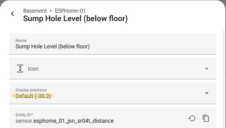

The configuration for the sump level sets it to 1 decimal:

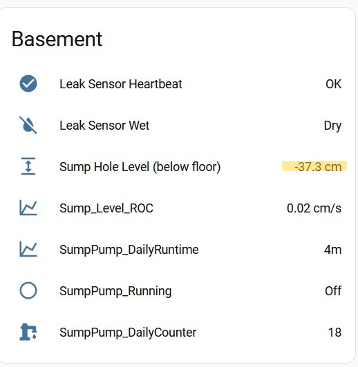

The overview and history displays match:

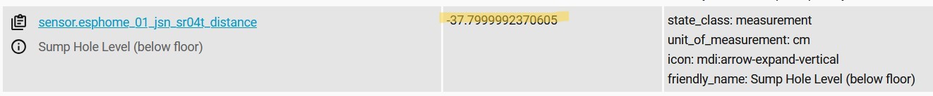

But on the Developer / States display as well as email and app alerts, it comes up with 13 decimal places:

Display precision in settings is only for HA front end, it will never effect the actual state. You need to do that with a round() filter and set the precison in what ever template you’re using to for your email and app alerts. Something like…
{{ states('sensor.esphome_01_jsn_sr04t_distance') | round(1) }}
Jinja docs for round()

As the value of a state in HA it’s always a string, so if you want to change it’s precision when sending the value via notify or what ever it needs to become a float (which is what the device is supplying anyways before it becomes an HA sensor state). round(1) does this without having to mess with the device firmware.

As for the long number of digits, I assume ESPHome sends it as text and then when HA gets it then it’s the old string → float → string conversion.
homeassistant:/config# python3 -c 'print("Round-trip:{:.30f}".format(float("59.2")))'
Round-trip:59.200000000000002842170943040401
