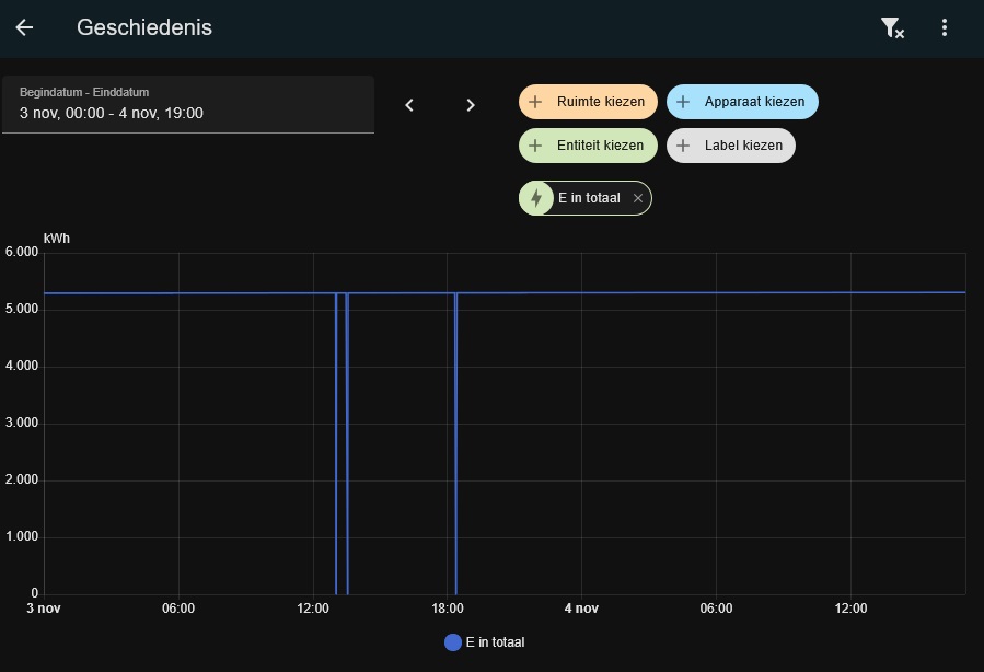

Since a month or so, not sure when it exactly started, an energy sensor (that is the sum of two MQTT sensors) shows occasional spikes.
These spikes coincide with these errors
2025-11-02 04:56:55.904 WARNING (MainThread) [homeassistant.components.mqtt.client] Error returned from MQTT server: The connection was lost.
2025-11-03 13:02:41.667 WARNING (MainThread) [homeassistant.components.mqtt.client] Error returned from MQTT server: The connection was lost.
2025-11-03 13:33:20.278 WARNING (MainThread) [homeassistant.components.mqtt.client] Error returned from MQTT server: The connection was lost.

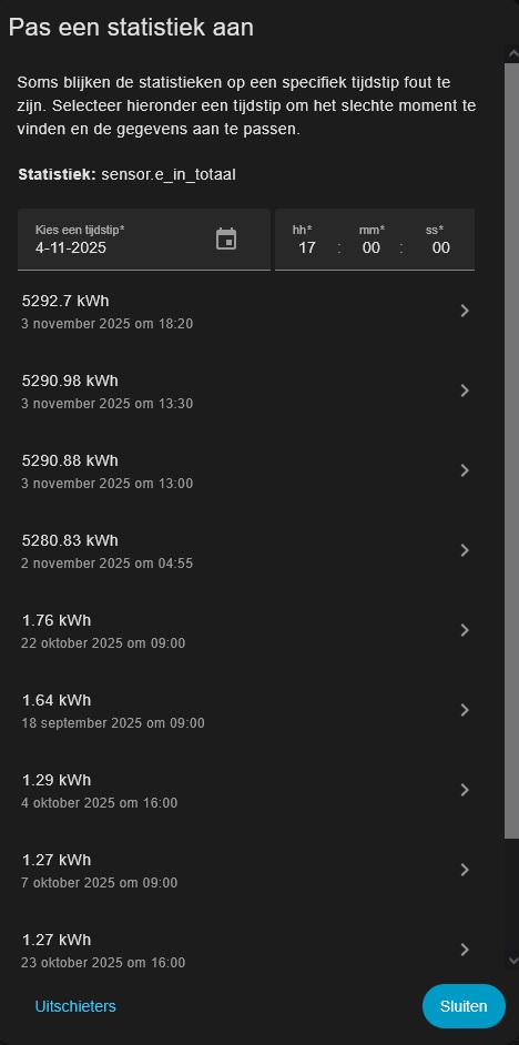

The last spikes occurred at 04:55, 13:00 and 13:30, same times as the MQTT errors. These spikes are the energy values at 5 minute intervals, which can be manually corrected using developer-tools/statistics. Usually these 5 minute values are about 0.02 to 0.04 kWh, when a spike occurs, they are over 5kWh.

Show the template doing the summing. I’m 99% certain it is missing an availability template, but there may be other improvements needed. It will also help to see graphs of the values of the components and the sum at the time of the spike.
ps. For the energy dashboard you don’t need to sum things, just list them both. It gives more informative graphs. The dashboard handles outages better (assuming sensors go unavailable as they should. If they are not unavailable at those times then the problem is in what sends the values).
And when that is done, look inty why all those dropouts?

Yes you have, but you did not know because you not have enough unavailability going on to notice.
"{{ float(states('sensor.e_in_1'),0) + float(states('sensor.e_in_2'),0) }}"
If one of these sensors is unavailable while the other is not (enough for the template to notice) this template returns about half of what it used to.
state_class: total_increasing
When that happens, in the energy dashboard, the other half is counted as totally new consumption or production, because toal_increasing treats it as a counter reset to 0 followed by a change for the half that was not unavailable.
There you have your spikes. Utility meters will behave just as bad. This has been this way for years.
The availability template makes sure the sensor is unavailable when not all data is present to get a proper result:
availability: "{{ has_value('sensor.e_in_1') and has_value('sensor.e_in_2') }}"
Sensors going to 0 unexpectedly without being unavailable is also a problem. When the right value returns you get a spike for the same reason. So even when both sensors go unavailable at the same time, you will still get the spikes because the 0 is treated as a total counter reset.
The drops in your graph should never happen. If the original mqtt sensor does this, then it should be fixed at the source. If that is i possible, you might need to extend the unavailability sensor to treat 0 as unavailable too. For total_increasing sensors that should not pose a problem.
@Edwin_D Thanks for the explanation :slight_smile: , availability template has been added.
The drops in the graph happen on the moments the log indicates a connection loss between the MQTT broker and client, both of which are running on HASS. I don’t suppose you could think of any reason what could cause that?

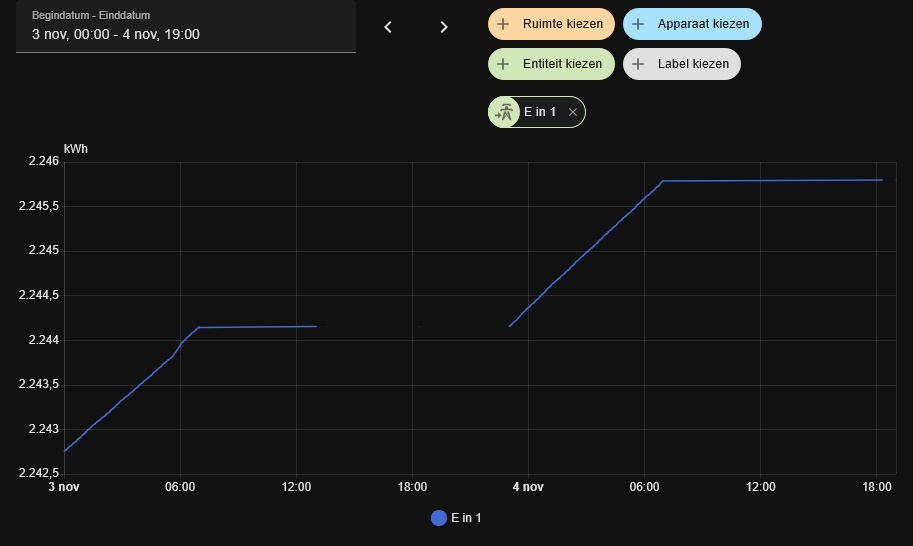

This is what E in 1 and E in 2 look like on the same day of the screenshot with the spikes (in the 5m values) and drops on the E in totaal graph:
The only thing out of the ordinary is that E in 1 seems to be missing some data, in a period it’s not increasing (daytime), E in 2 is increasing like it should. Both of which are send in the same MQTT-datamessage and also with gas and grid voltage.
