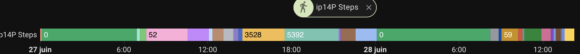

Is there a way to use sensor.iPhone_step as a “measurable value” to add to “statistics” or a graph?
In my experimentation, “step” appears as a string instead of an integer so I can not graph or build automation based on value.

thanks for your answer, data are present in home assistant like state and not as a value. How could I convert string as value easily.
Thanks
Thks,
I used this in configuration.yaml
it works
template:
- sensor:
- name: ip14step
unique_id: ip14stepcalc
state: >
{{ '%d'|int(states('sensor.ip14p_steps')) }}
state_class: measurement
