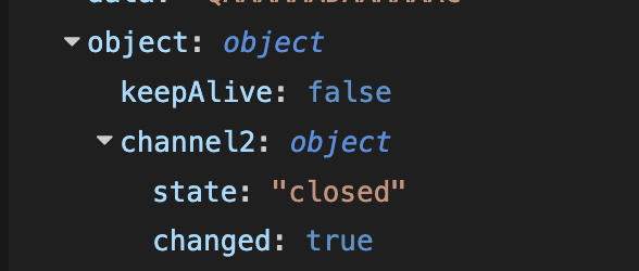

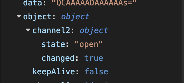

The TOR2 is working fine, I have configured it to edge high & low. When the door opens I get open via MQTT, and closed when its closed.
closed, keepAlive: false because the input event has triggered
open, keepAlive: false because the input event has triggered
issue

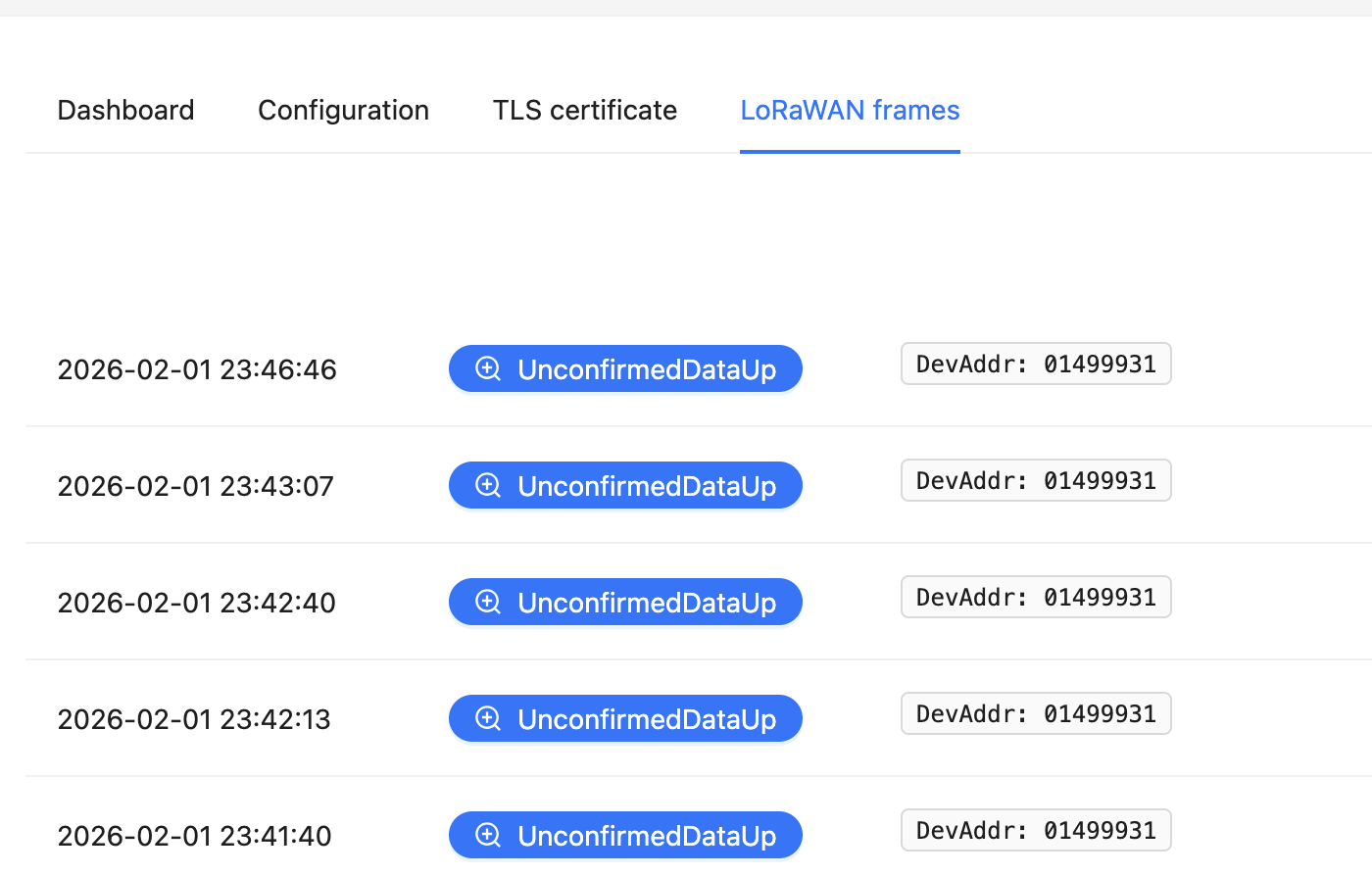

TOR1 is configured with only high edge. The micro-switch is normally closed, meaning the lever pushes on the micro-switch. I would like that I get “open” when the lever does not push anymore on the micro-switch because a letter has been put into the box and the flap opens.
However I get either state open and keepAlive true (where I would expect keepAlive is false and state open). The next time I get keepAlive false and state “closed”.
question: What do I need to modify in order to get keepAlive false and state to open when the micro-switch is not being pushed down from the lever?
Whenever I release the the micro-switch I get Lora-frames
Appreciate any help, I spent hours with Chat GPT, Github etc. and could not find the reason for this behaviour.

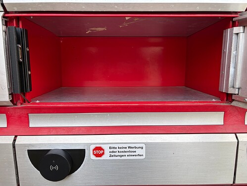

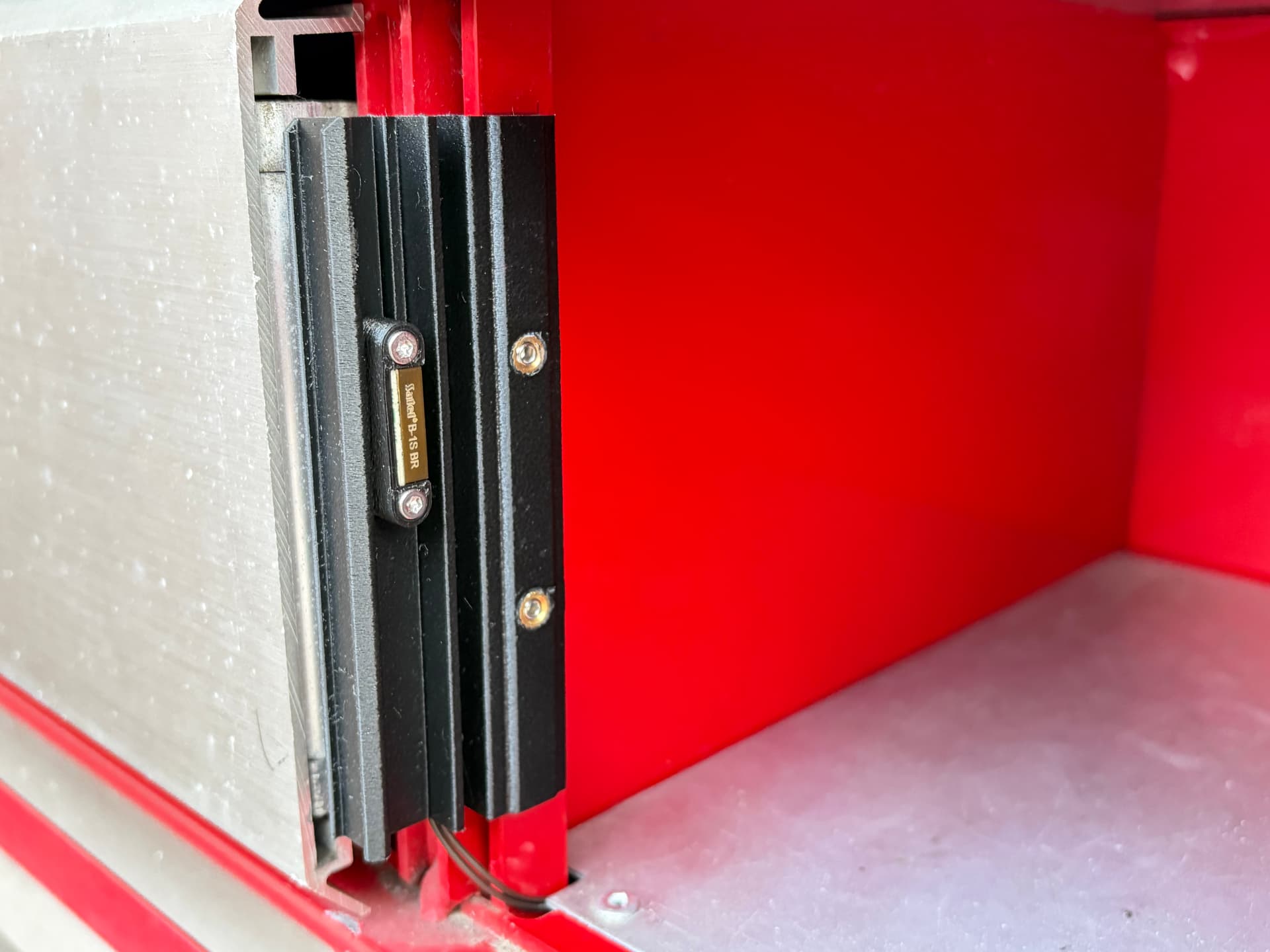

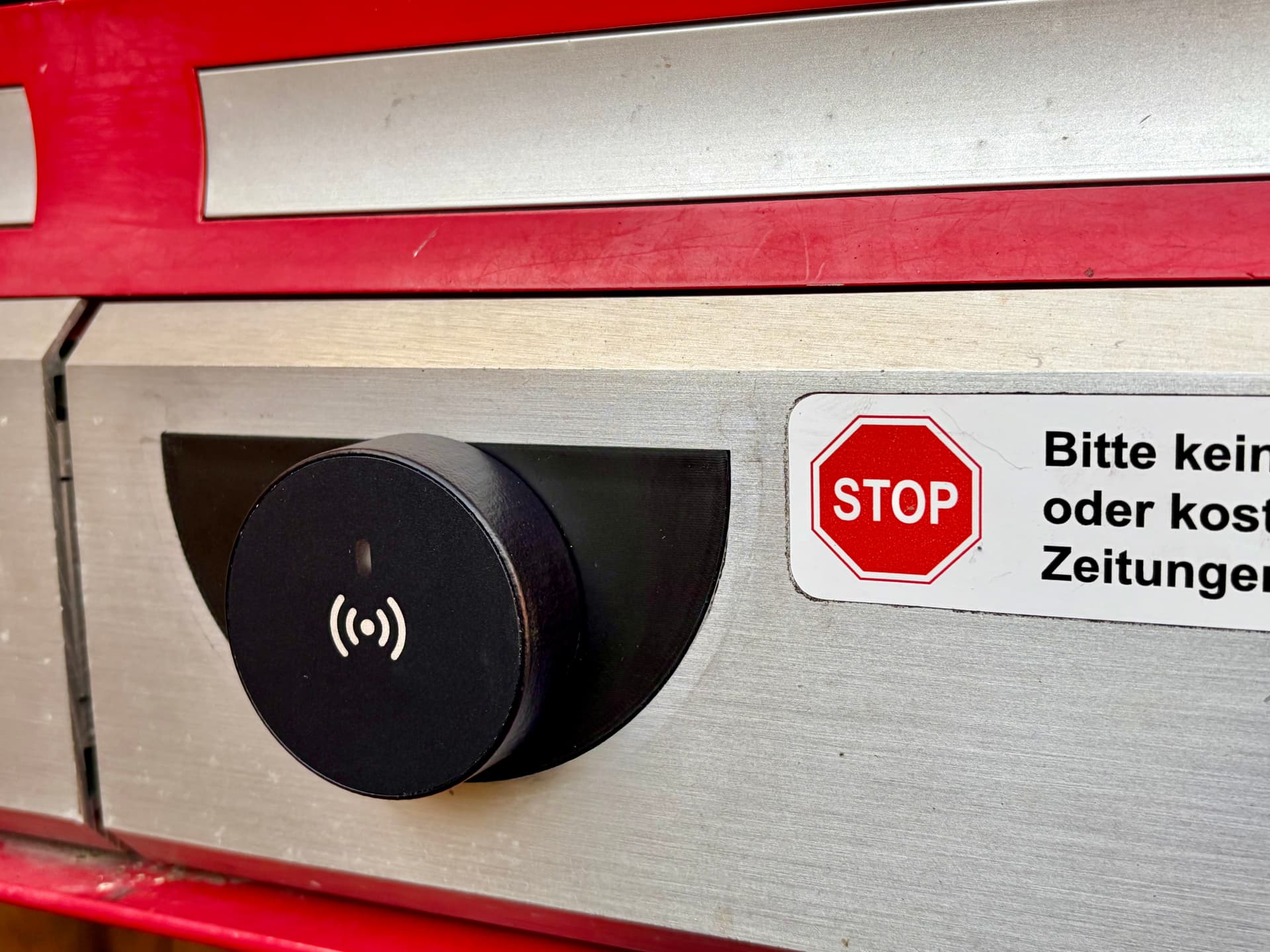

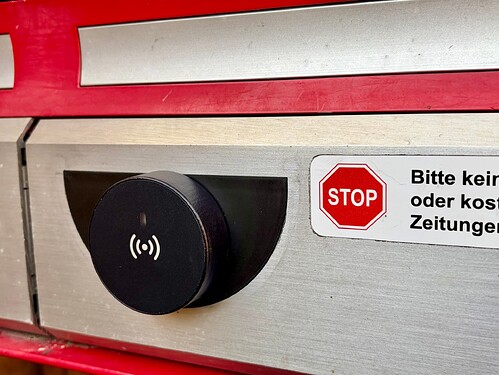

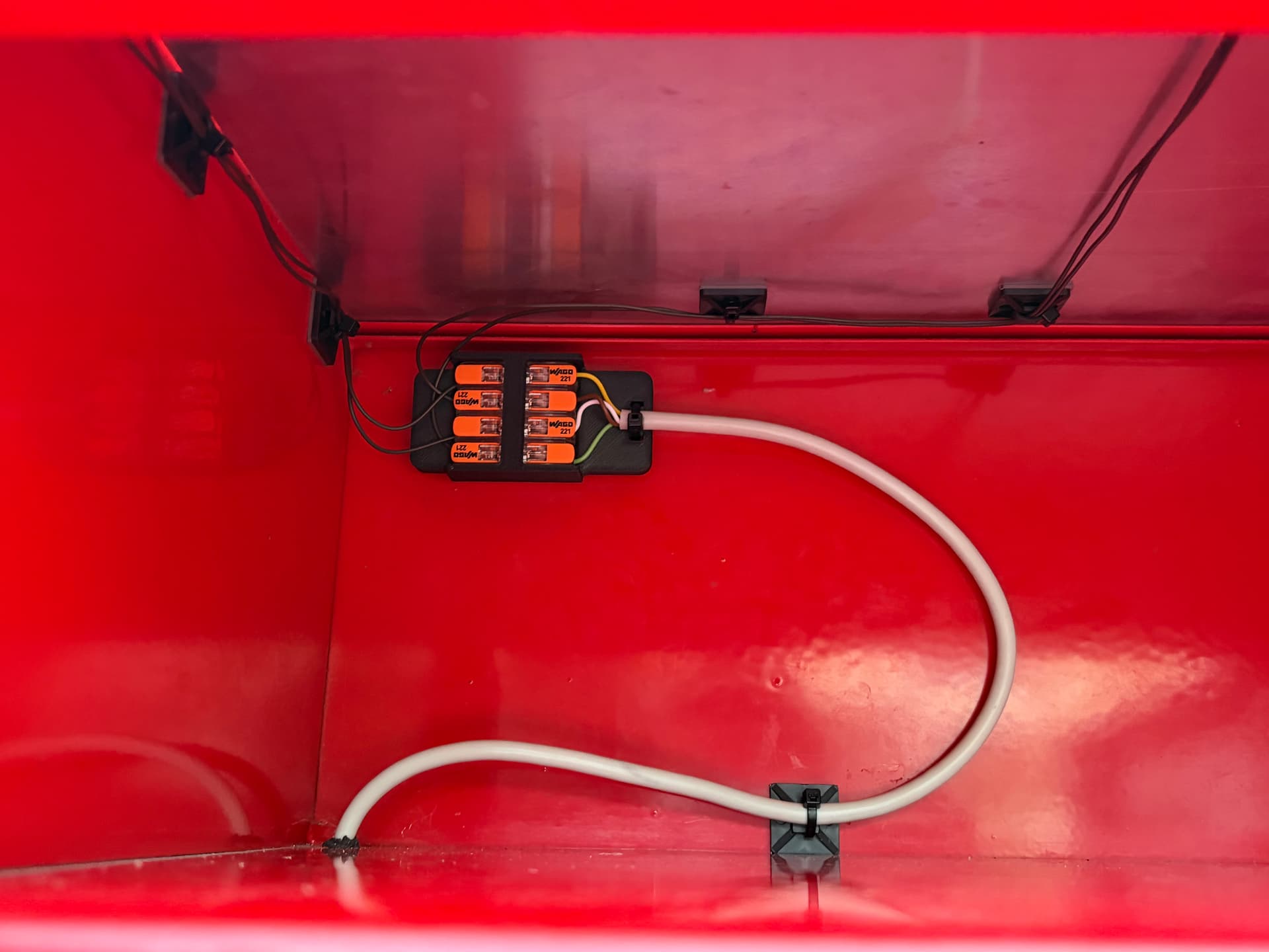

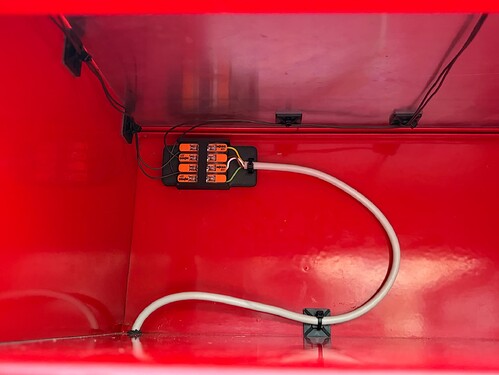

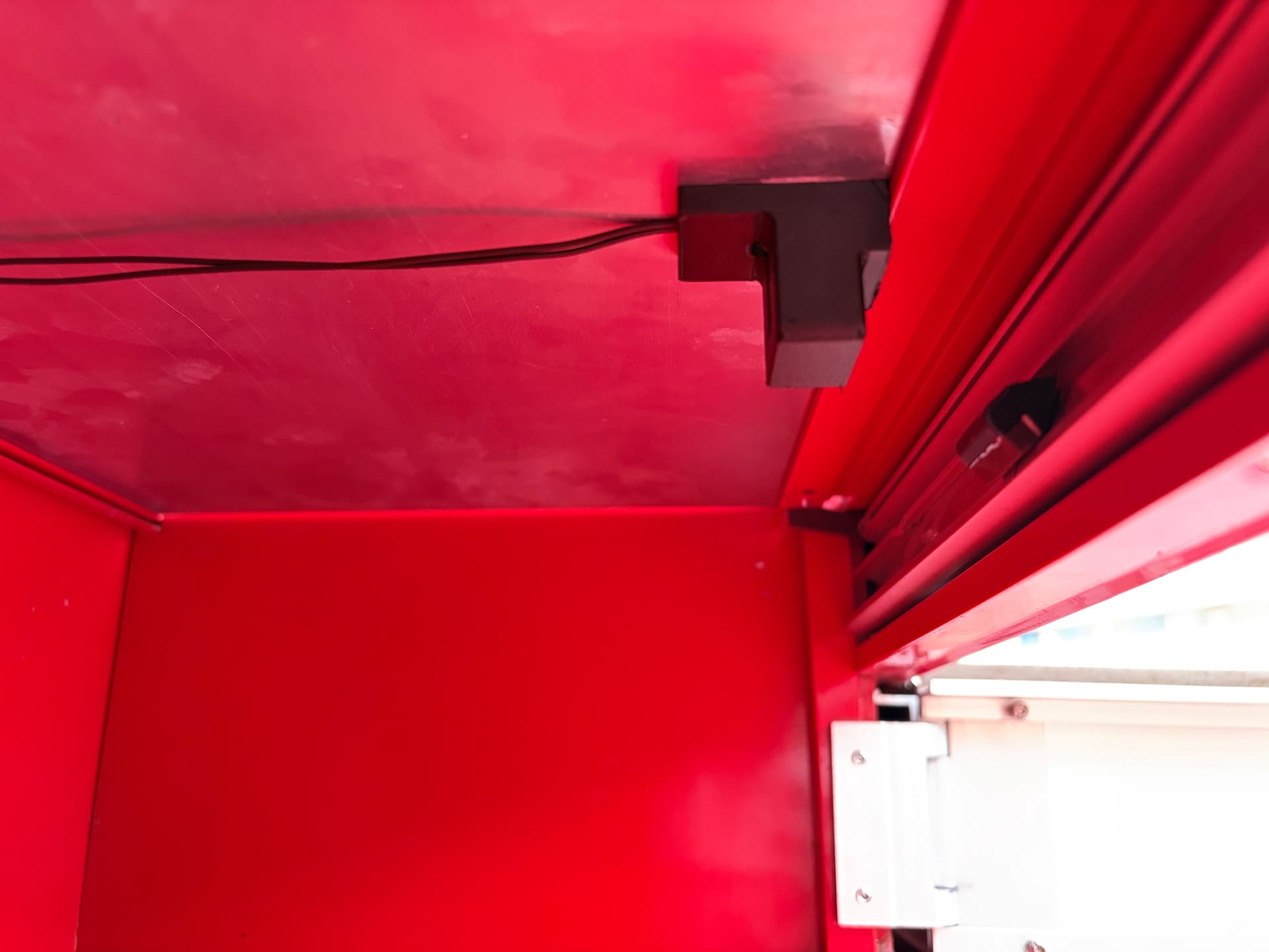

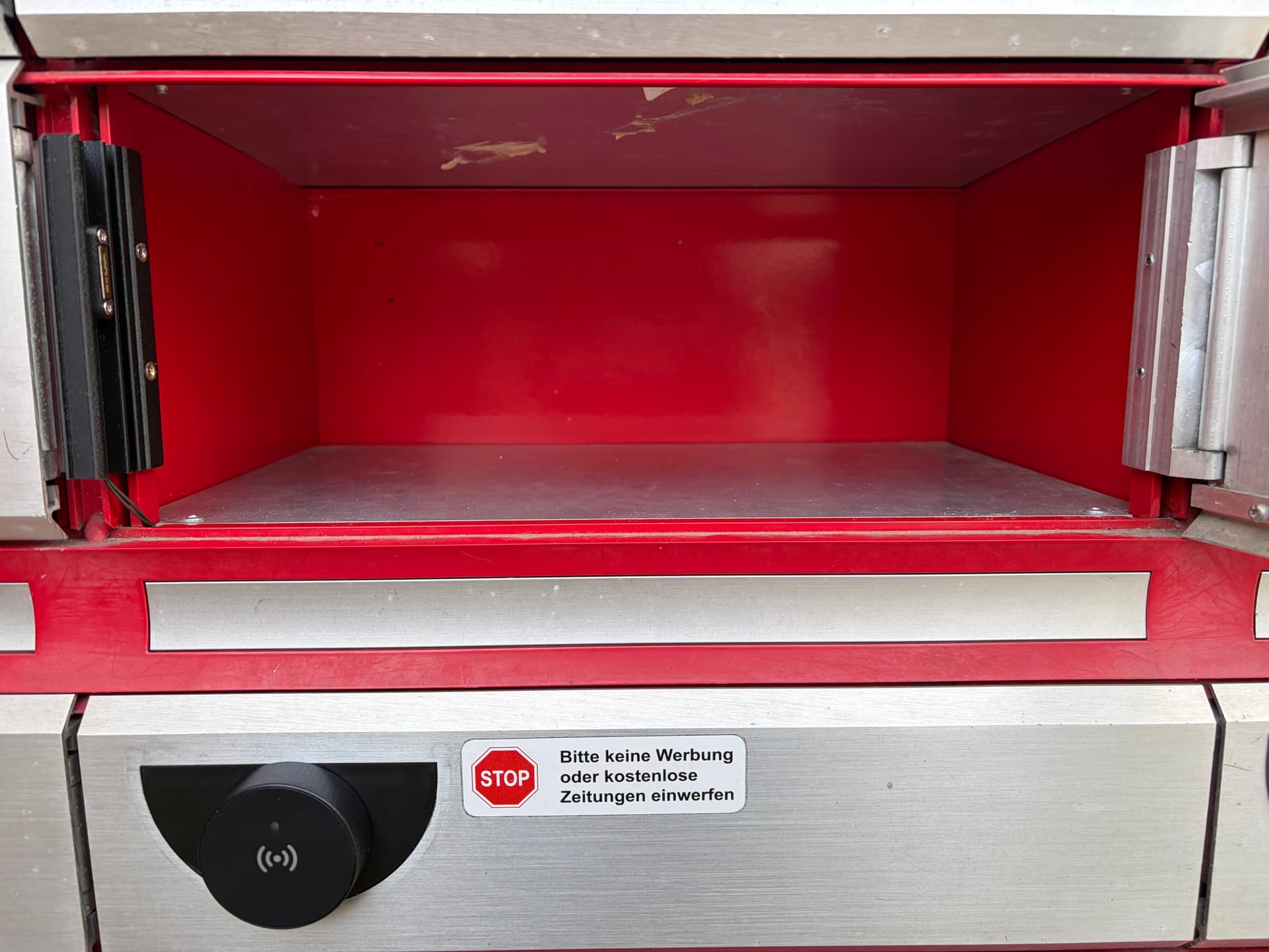

finally after weeks of engineering (and even 3D-printing my mailbox in full scale :sweat_smile:) I managed to build a reliable system that detects both the parcel box and the flap for letters. Big thanks to @vhuynen for the amazing project that gave me a lot of inspiration: Github project
I built my solution around a few key principles
• reliable detection
• weatherproof
• detachable in case of repair/maintenance
• no modification of the mailbox required
In my case I use two miniature reed contacts connected to an Adeunis Dry Contact sensor which is IP68-rated and battery-operated. The sensor sends the data via LoRaWAN to my weatherproof (and awesome) RAK7289V2 gateway. From there the data goes to my ChirpStack server running locally on my Synology NAS. It’s then published via MQTT into Home Assistant, where I process everything further in Node-RED.
And if you think that’s the whole story… not quite.
Since I have a smart front door, I also wanted to avoid using a physical key for the mailbox. After quite a bit of research I found these amazing NFC-powered smart locks from SMALOX — NO battery required: https://www.smalox.com/locks/smalox-twist
Huge thanks to SMALOX for providing a sample. I designed and printed a housing based on the original lock design and integrated the SMALOX Twist. It works perfectly — I just open the app and lock or unlock the mailbox.
