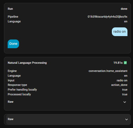

I’m really struggling with this. The underlying objective is to turn on my music assistant and play a radio station from a list. I have absolutely no problem with turning the media player on or off by voice assistant:

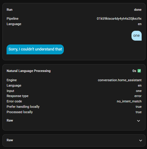

and the log shows:
age: done
run:
  pipeline: 01k59ktsca4dy4yh4s20jkez9x
  language: en
  conversation_id: 01K9S784WSAXCBFHYBSWZD043B
  runner_data:
    stt_binary_handler_id: null
    timeout: 300
events:
  - type: run-start
      language: en
      runner_data:
        timeout: 300
    timestamp: "2025-11-11T10:26:53.857245+00:00"
  - type: intent-start
      engine: conversation.home_assistant
      language: en
      intent_input: one
      device_id: null
      satellite_id: null
      prefer_local_intents: true
    timestamp: "2025-11-11T10:26:53.857274+00:00"
  - type: intent-end
      processed_locally: true
      intent_output:
        response:
          speech:
            plain:
              speech: Sorry, I couldn't understand that
              extra_data: null
          card: {}
          language: en
          response_type: error
            code: no_intent_match
        continue_conversation: false
    timestamp: "2025-11-11T10:26:53.859058+00:00"
  - type: run-end
    data: null
    timestamp: "2025-11-11T10:26:53.859103+00:00"
intent:
  language: en
  intent_input: one
  device_id: null
  satellite_id: null
  done: true
  intent_output:
    response:
      speech:
        plain:
          extra_data: null
      card: {}
      language: en
I am struggling to understand why my initial speech is recognised, but my response isn’t. Can anybody help me interpret the error log? Thanks in advance.
doh !! speech to text translates “one” to “1” so there was never a match.
