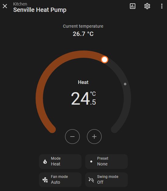

For anyone needing senville integration for their air units, this worked for me.
  1. Make sure your usb dongle is the wifi version, not the Alexa version.
  2. Add the air unit to your senville app.
  3. Downlaod Midea Local AC from HACS Store.
  4. Select discover devices.
  5. Type in the IP Address of the air unit. You can get this via your router or dhcp log.
Once added, it will fill in the keys, tokens, etc. This took me days to find, so for anyone having this issue this is the fix.
