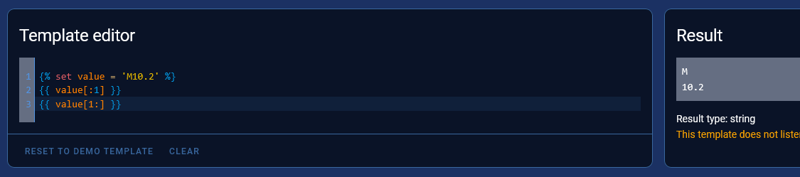

Is it always one letter in front?
If so, just slice the string. Have a play with this in the template editor.
{% set value = 'M10.2' %}
{{ value[:1] }} # first character only
{{ value[1:] }} # everything after the first character

Thank you tom_l for your fast answer.
This solution is exactly what i need. In template editor it works as you wrote but in configuration.yaml it is ‘unknown’
