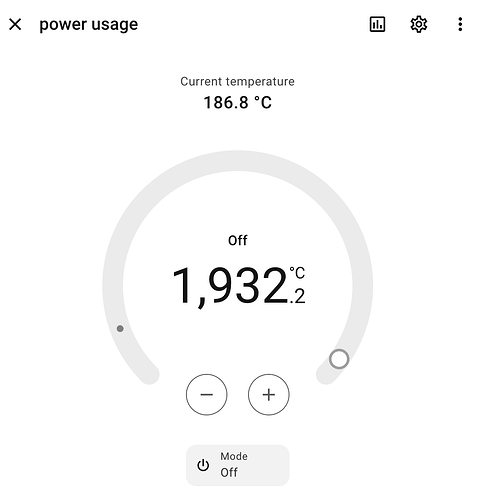

Something I have wondered about (I haven’t actually tried it) is to use generic thermostat for these kind of problems.
The critical observation is that most of the things you want to do are very similar to what is wanted for controlling heating or AC units - turn something on above a certain level.
The idea would be:
  • Use a sensor to feed the current power (instead of temperature) into the Generic Thermostat.
  • Set it to “cool” since you want it to turn on devices above a certain number.
  • Set the output to switch on the device.
  • Repeat 3 times for each of your devices (one thermostat for each device)

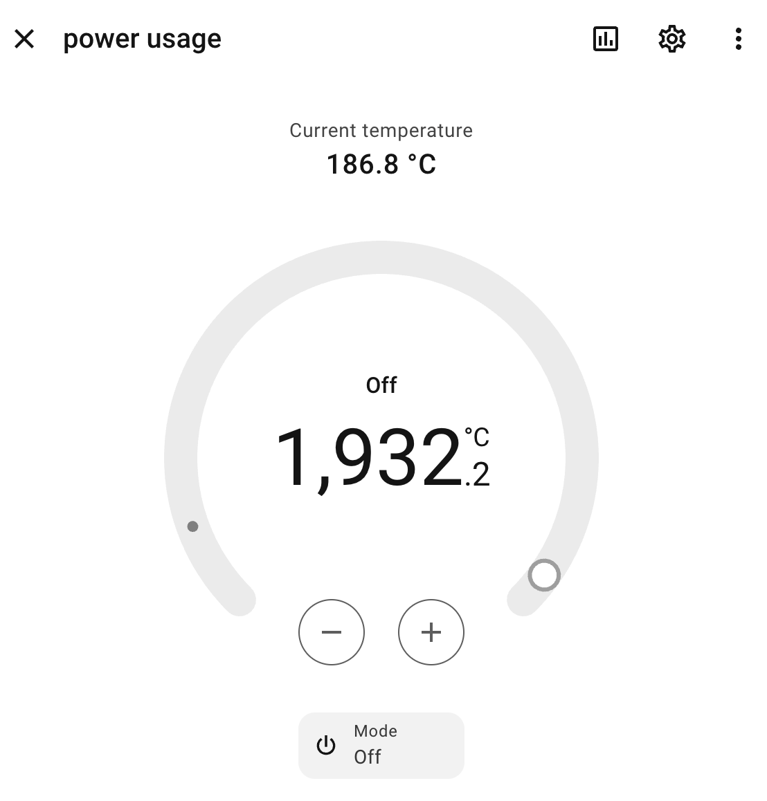

That way you get a nice UI to set the power levels:
The problem is you can’t change the wording:
  • Its says “current temperature”
  • The unit of measure is °C or °F
As I said at the beginning I haven’t tried it but its something I want to try when I have a need.
A quick update you need to create a temperature sensor (even if its really reporting power) to use with the generic thermostat - so its getting really kludgey now…
