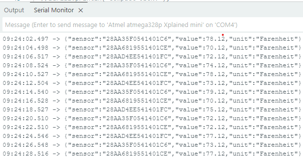

Hi, I am attempting to configure multiple DS18B20 sensors that are read serially (json formatted) from a connected Arduino. The serial data from the arduino looks like this:
My configuration.yaml entry looks like this:
