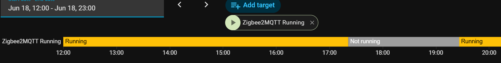

I wanted to use the Service Info sensor if an App is running (in particular Zigbee2MQTT). Today I noticed that the Service Info (proviced by supervisor) is staying at the state "running" for several minutes before it changes to something else (eg unavailable). Well if at all.

Yes, I mean that one. Mine keeps staying at "Running" for several minutes even though the App is not running anymore.
Yep, you're right. Had a closer look at my logs & the state of the sensor is off by 2-3 mins from when the outage occurred.
