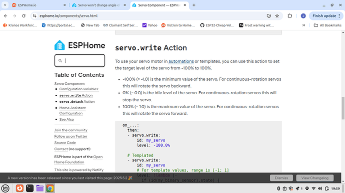

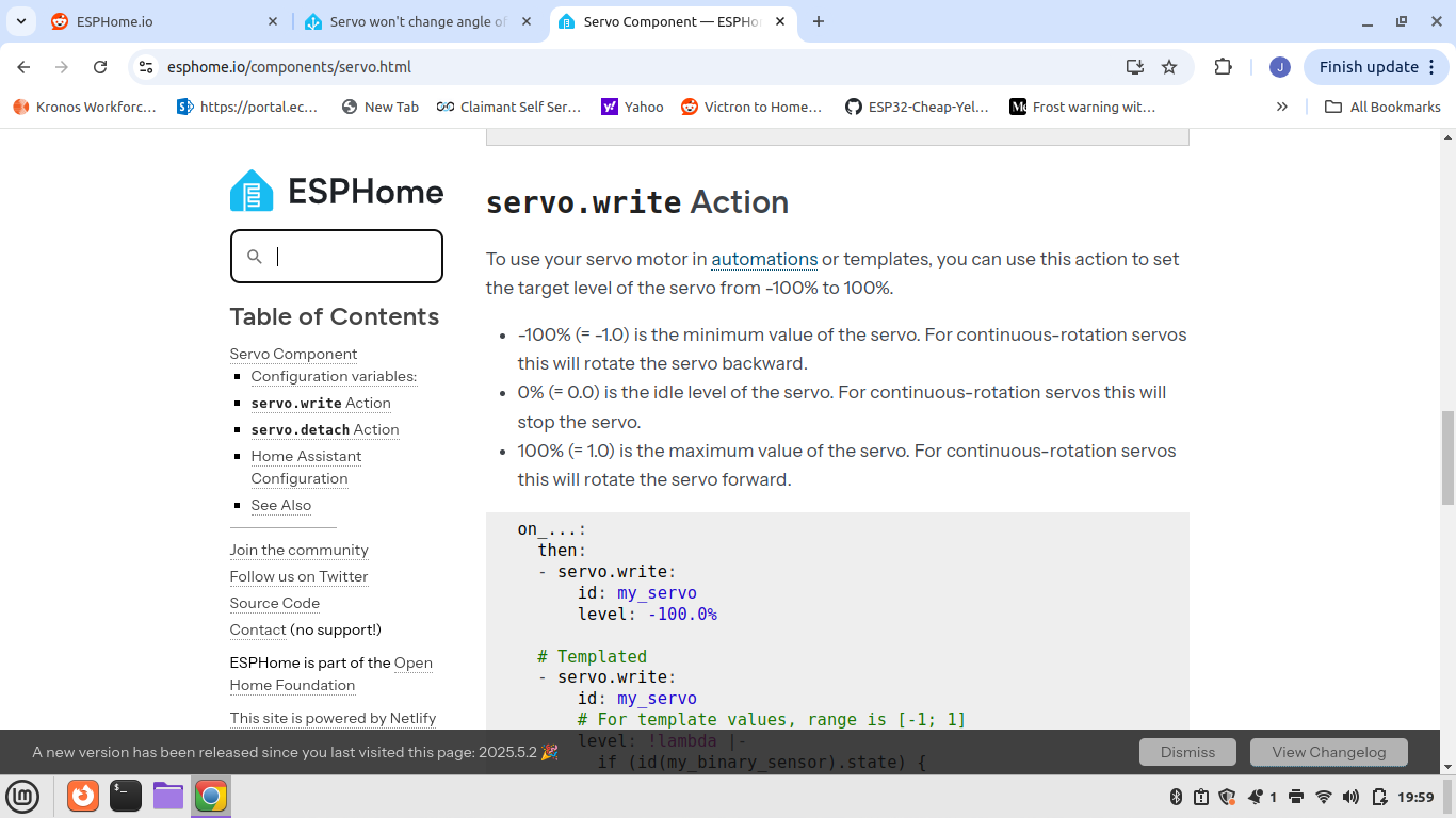

servo range is from -100 to 100 (0-180deg, 0 in the middle)
Esphome has a website full of very helpful information and also instructions for using each of it’s different integrations like Servo that will explain how to operate it…
