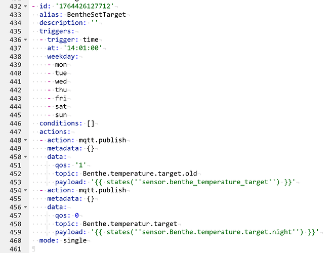

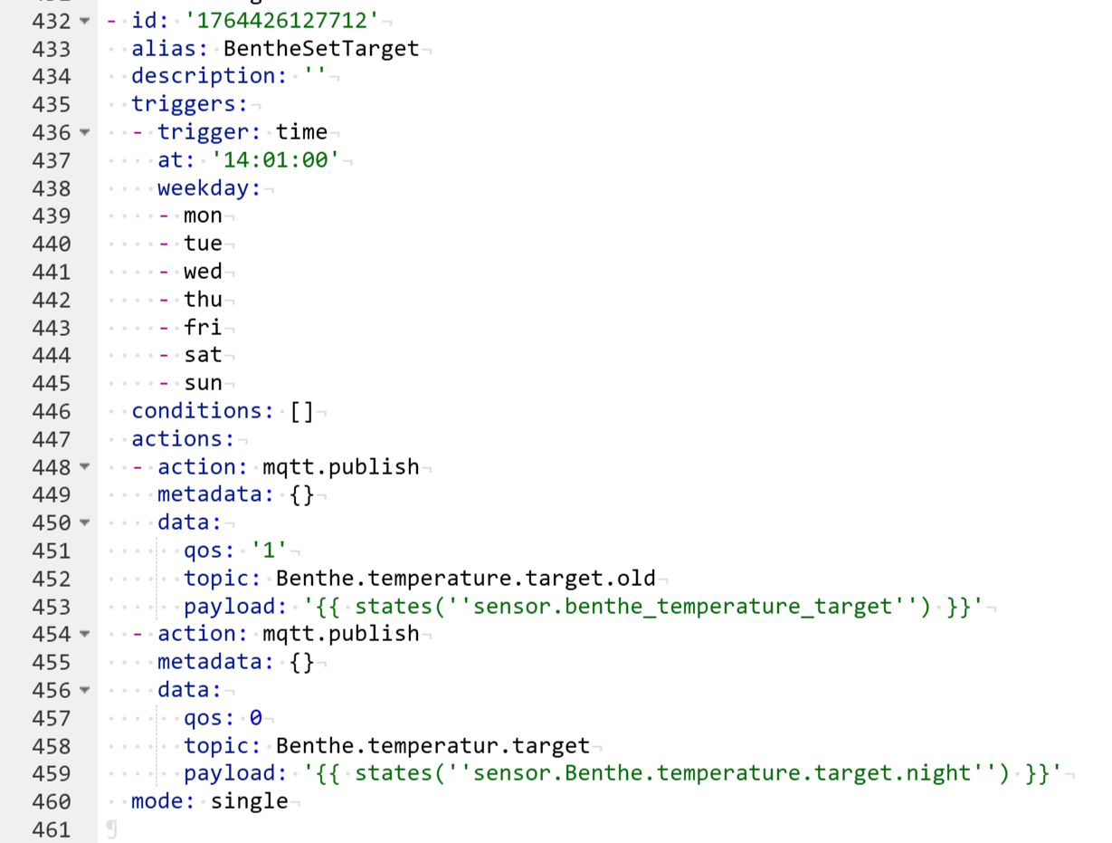

automation.yaml:
- id: '1764426127712'
  alias: BentheSetTarget
  description: ''
  triggers:
  - trigger: time
    at: '14:01:00'
    weekday:
    - mon
    - tue
    - wed
    - thu
    - fri
    - sat
    - sun
  conditions: []
  actions:
  - action: mqtt.publish
    metadata: {}
      qos: '1'
      topic: Benthe.temperature.target.old
      payload: '{{ states(''sensor.benthe_temperature_target'') }}'
    metadata: {}
      qos: 0
      topic: Benthe.temperatur.target
      payload: '{{ states(''sensor.Benthe.temperature.target.night'') }}'
  mode: single

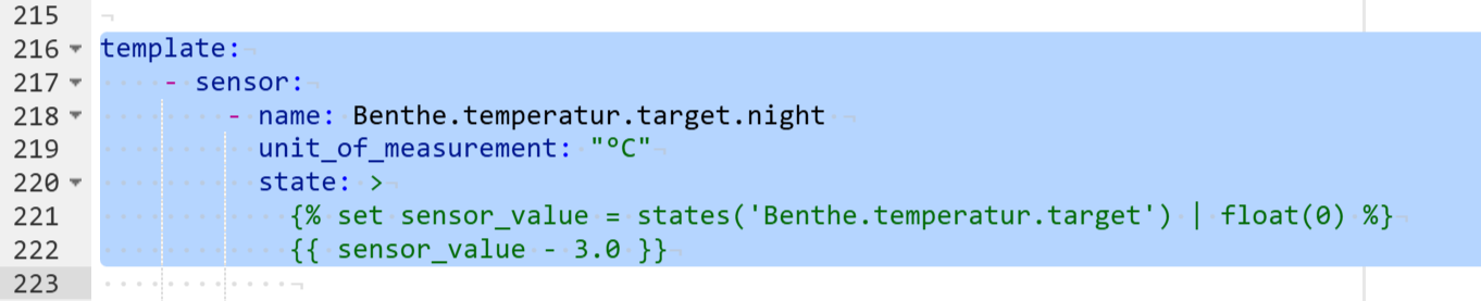

configuration.yaml:
  template:
    - sensor:
        - name: Benthe.temperatur.target.night
          unit_of_measurement: "°C"
          state: >
            {% set sensor_value = states('Benthe.temperatur.target') | float(0) %}
            {{ sensor_value - 3.0 }}
