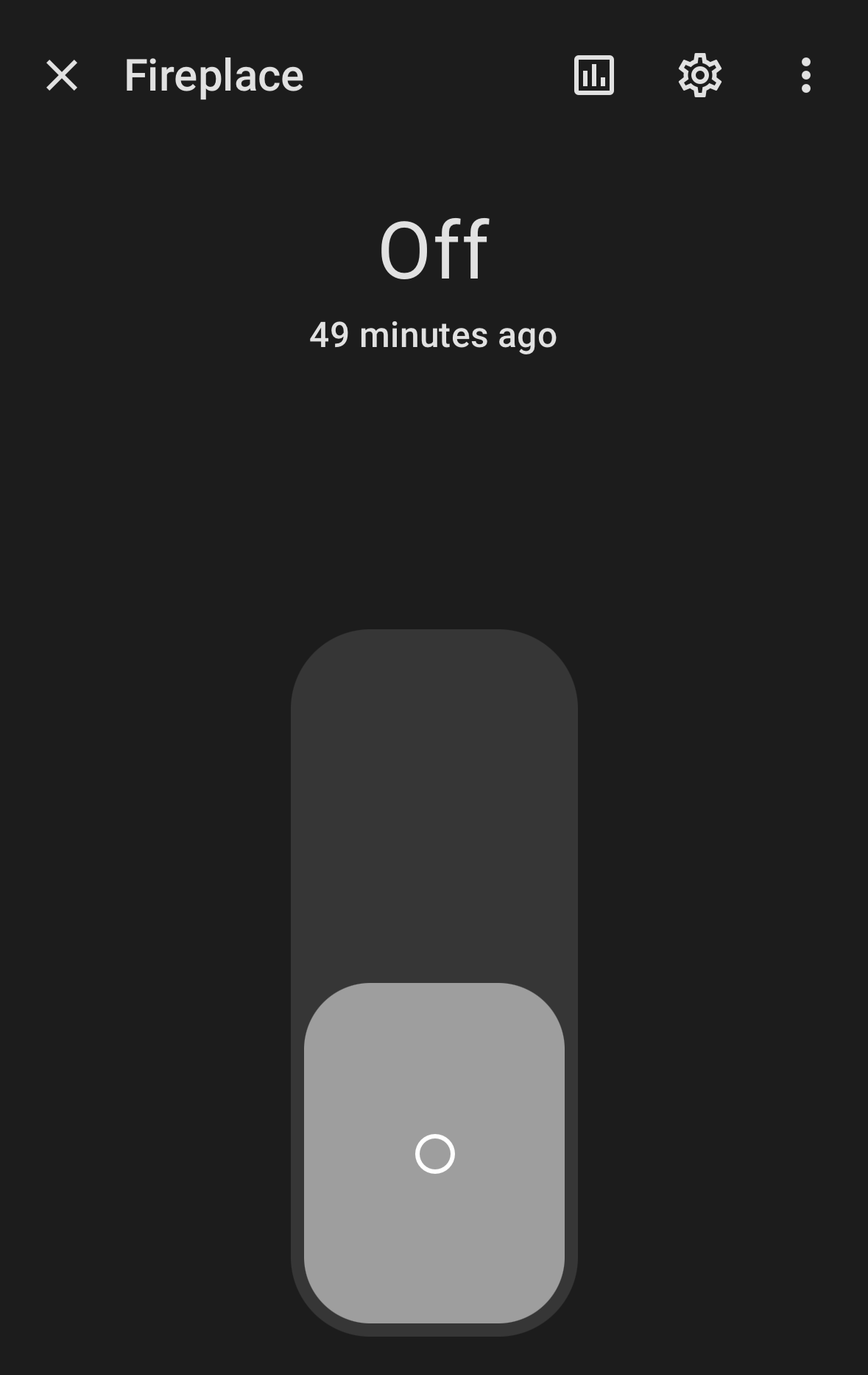

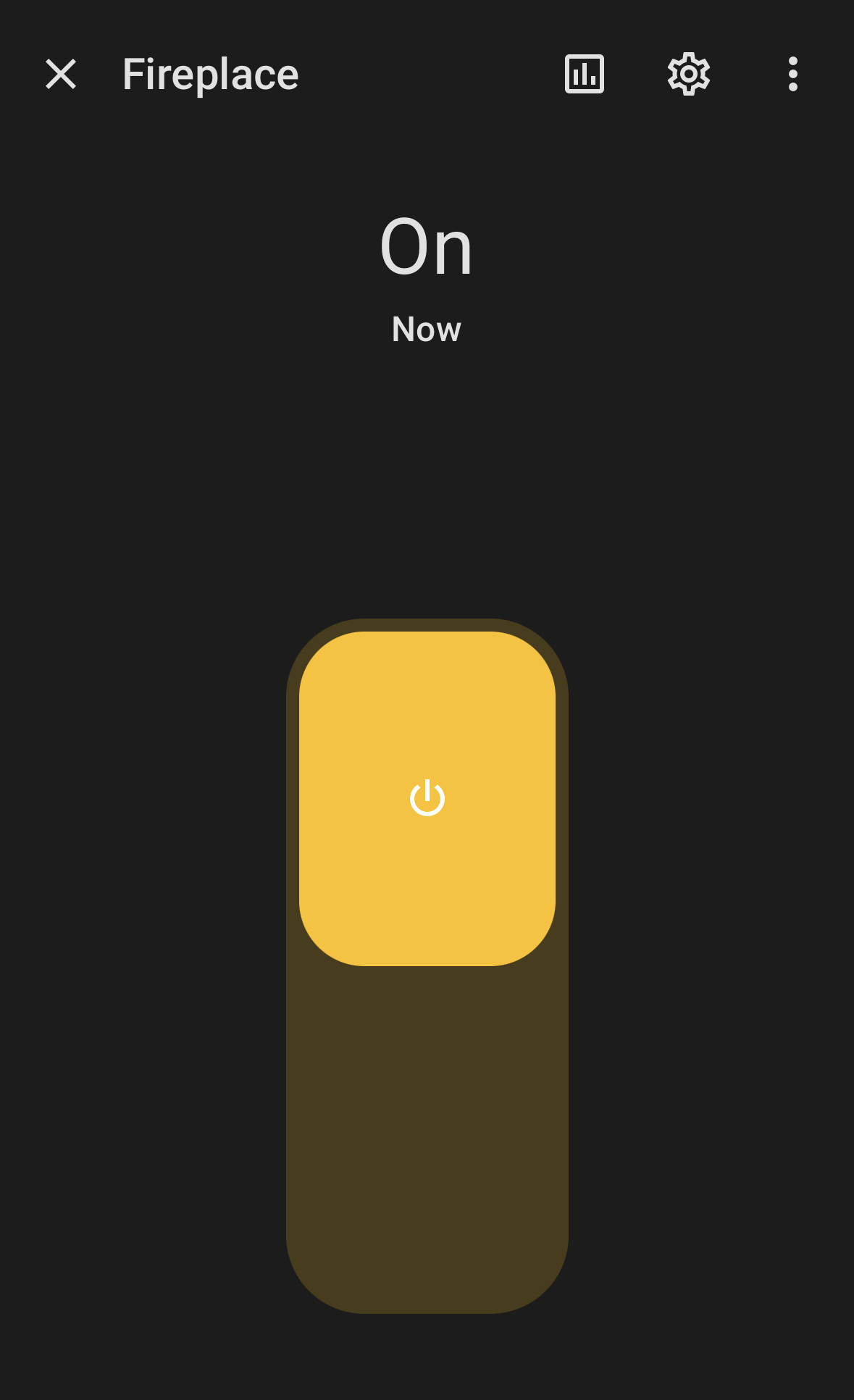

Even when not on a dashboard, just viewing the switch entity will show you this:
This is a zwave switch and it responds essentially instantly for me, so I see this as soon as I command it on:
If it wasn’t responding, it would have switched to ON but would still show “49 minutes ago”. And when you close and re-open the entity dialog (or just refresh it), it would revert back to the OFF state.
Again, keep in mind this behavior isn’t unique to what you are doing with your RPi and MQTT. This is how every switch in HA behaves.
