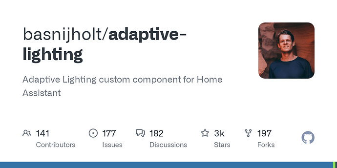

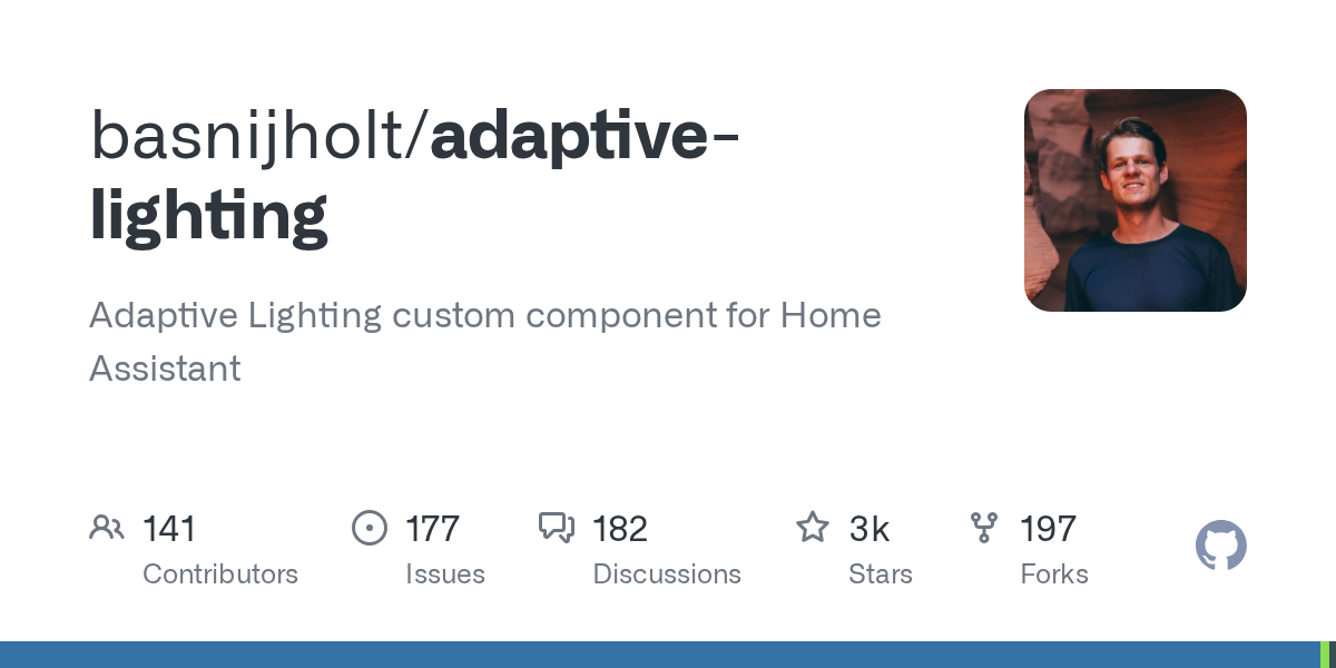

Maybe adaptive lightning can solve all your problems? :hugs:
