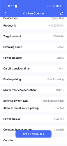

Thank you for doing that. This is what I see in the app, and I’ve tried to adjust the “Min current consumption” up to 20% with no change.
There’s a dimming curve option right there in your screenshot (4th entry).
Revert the change you did on Min current consumption, then play around with the Dimming curve option
