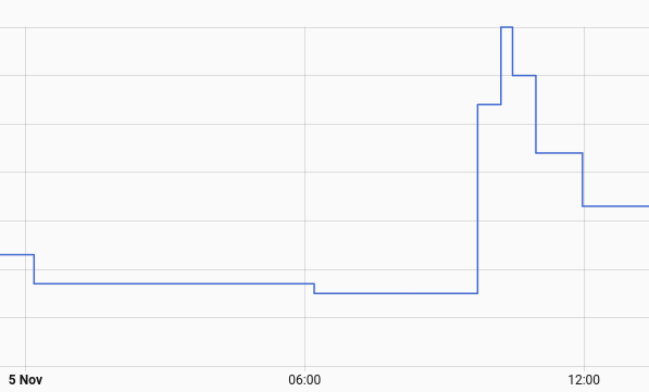

Before a quick check, I was going to say mine only update every 4h-ish, but the Temperature Report Interval parameter seems to be working somewhat here:
Problem is I know it is able to work.
The same sensor was working fine on my previous Z-Stick. Unfortunately, this died and I moved over to Z-Stick 10. Have not been able to get the sensor to work properly after the move.
I have two sensors on firmware 2.8 which are not working properly. The one on FW 3.4 works fine. And 2.8 is the latest available for those two.
