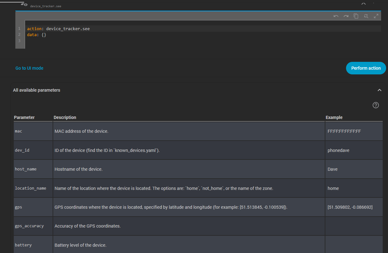

I already stated what you should use, which supports that. Device Tracker See action.
Use petro’s suggestion.
device_tracker.see
The device_tracker.see action can be used to manually update the state of a device tracker

No, you just need to stop using the python set script and switch to device tracker see action.
I’m not using fake words here and you’re glossing over them, Device tracker see action.
alias: Home_away change
description: ""
triggers:
  - trigger: state
    entity_id:
      - input_button.home_away_button
conditions: []
actions:
  - action: notify.mobile_app_iphone_1
    metadata: {}
      message: Changed status to 'away'
  - data:
      dev_id: iphone_1
      location_name: not_home
    action: device_tracker.see
or set the gps location
Thanks. That’s very helpful. I thought device_tracker.see depended on having Device Tracker initiated in configuration.yaml.
I appreciate your help. I can now get rid of the additional python script, which makes everything much tidier and less prone to future deprecations.
