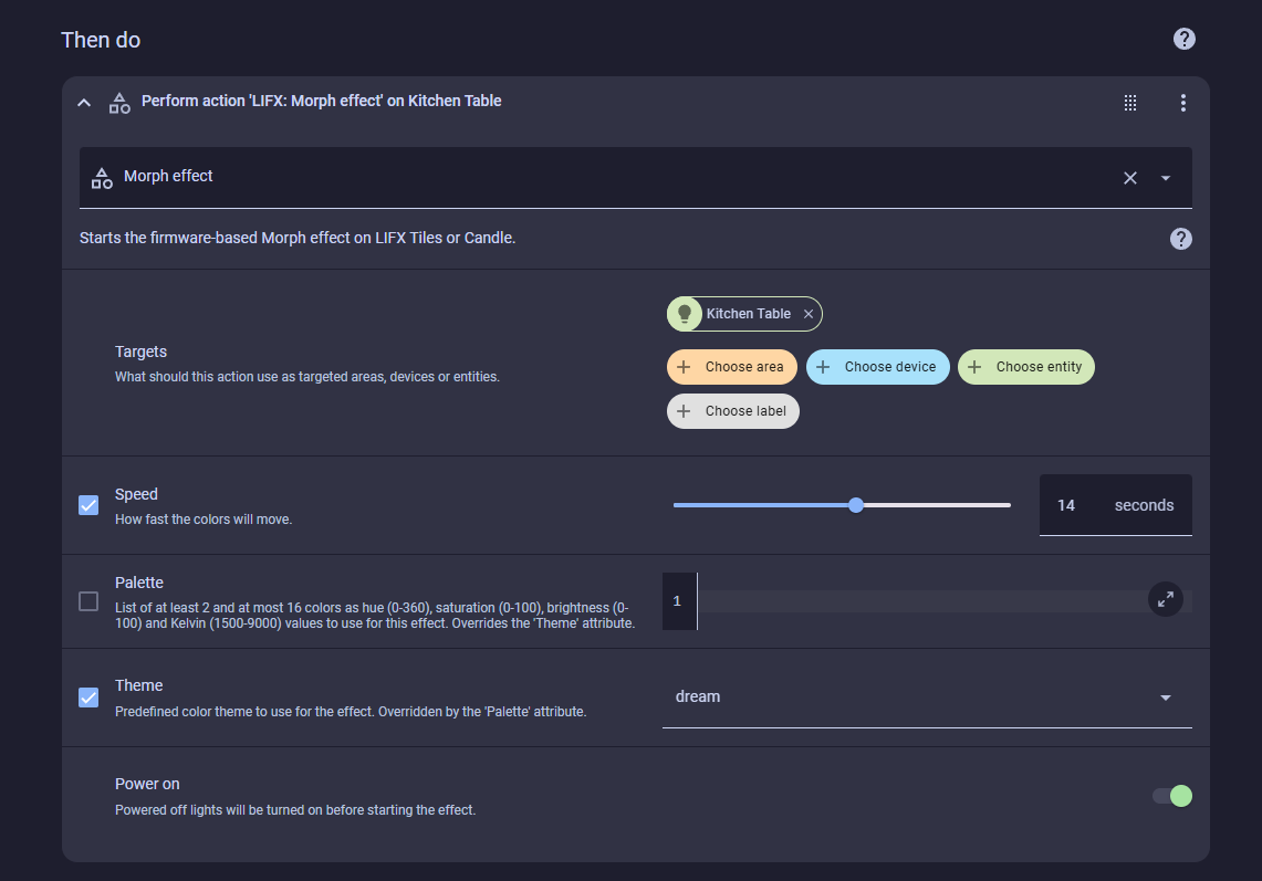

Unsure if it’s helpful, but here’s the UI for the automation page on the action details. Even if I build from scratch, using only the UI, selecting a theme, it doesn’t do anything on the light. The resulting YAML letting the UI build it matches exactly to what’s already been posted, so I’ll save the characters in the post.
Did you try using a theme instead of a pallette?
Yes, as shown in the screenshot.

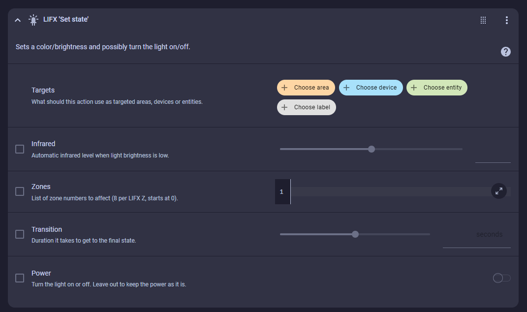

I’d be curious to know if changing that light.turn_on action to a lifx.set_state action would achieve the same result or not. Either way, I’m glad you have something working for you.
Looks like it does. I wasn’t aware that brightness_pct was a valid option, and the UI for the set_state action doesn’t imply it accepts additional parameters, so I hadn’t looked further. I did see in the documentation it claimed to support all the normal light_on parameters, but since the UI didn’t provide a place to put them I just trusted that the integration knew better than I did, heh. For reference:
The UI provides a bunch of targeting options, but doesn’t really offer or show any options to do something. I had written this off because of that, and didn’t bother to look further. Once I manually edit the YAML file to include brightness_pct, the entire “template” UI just goes away and it shows me the raw YAML, but seems to work fine.
Since this approach is likely to be more reliable than the hacky way I had it set before, I’ll just use this going forward.
Should I make a second request for the LIFX integration regarding the UI for set_state to be updated to show the parameters it can handle, or would this be considered a bug as it doesn’t match the docs?
You can, sure. I suspect it may have been either a limitation or an efficiency when the integration was first developed to just use the existing light.turn_on fields but perhaps they couldn’t surface them. I think we can now, but I won’t know until I try and having a bug report ia good motivation to do so.
