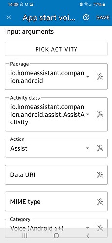

Hello, first of all thanks for the topic. I think I have done everything you indicate, but I can’t get it to work.
  1. I have installed HA companion on my Samsung A50 mobile with android 11
  2. I have installed “Hotword Plugin”
  3. I have installed the “Automate” app
  4. I have created my personal wake word with Snowboy and I have loaded it in “Hotword plugin”
  5. I have created an automation in “Automate” of which I show the screenshots.
However, when I say the “wake word” (“Hey you”, in Spanish) the mobile does nothing, I don’t see any reaction, even if I link it with some instruction that I have already created in Assist.
What am I doing wrong or what am I missing? Any help is welcome. Greetings.
Please, can someone help me?

If you’re not even hearing a ding from hotword plugin then I’m guessing you’ve got some kind of microphone permission issue thats preventing it from hearing you. Either that or maybe the sensitivity is set too low and it’s not registering that you said the hotword.

I got almost to the end of setting this up, but strangely launching the AssistActivity fails
Launch App: failed to launch io.homeassistant.companion.android.assist.AssistActivity. (Error Code: 1)
Simply launching the Home Assistant companion app works, so I’m not sure where the problem originates from.
I was wondering if anybody encountered similar before?

Did you ever find a solution to this?! It’s maddening. I’ve tried both Tasker and Automate, and they both give the same error. It’s as if the ASSIST instance can’t be seen.
