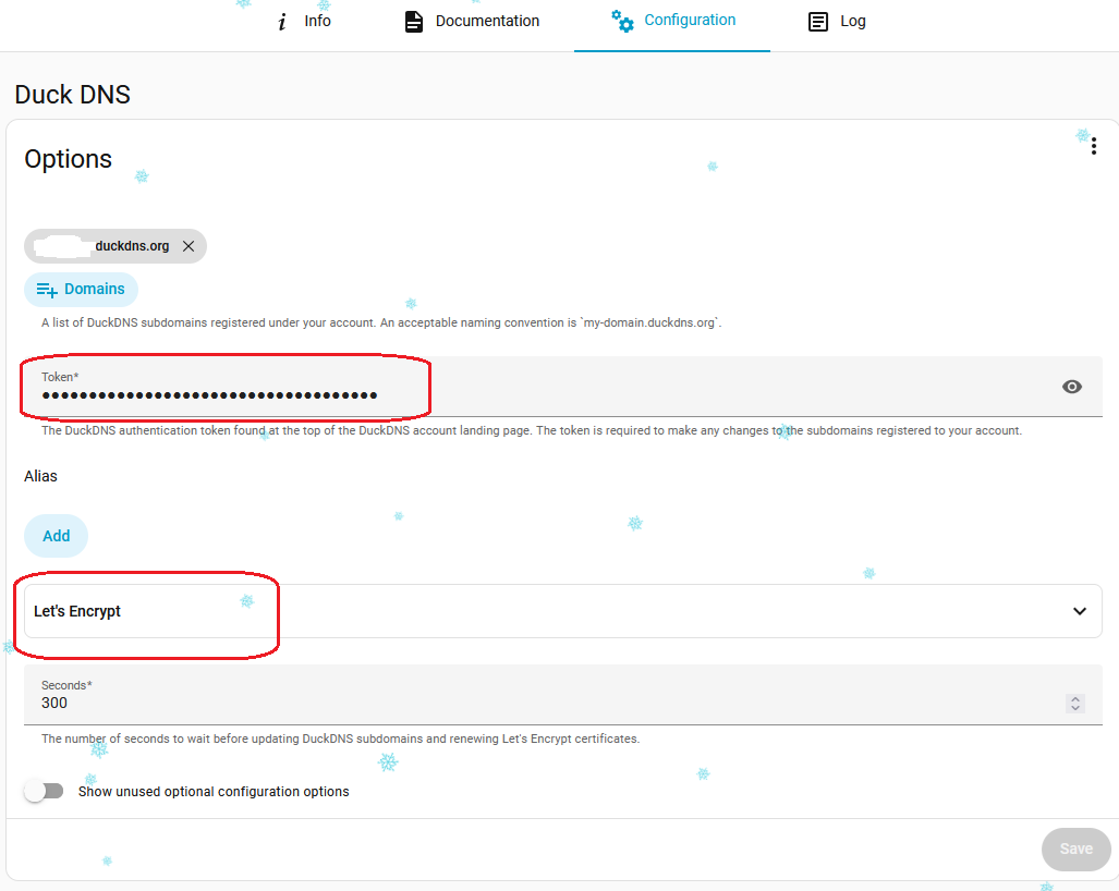

Hello. I have a couple of questions. If you’ve done everything correctly, then everything is fine. The problem lies elsewhere.
  1. Have you created an account and URL at https://www.duckdns.org/
  2. Have you added/selected Let’s Encrypt in your Duck DNS configuration?

To be able to use https obviously you need to issue certificates for your site (xxx.duckdns.org), most common way is to use LetsEcrypt services for this purpose.
DuckDns doesn’t provide certificates , just DNS names.
You have to add “server_port: 8123” to http before “ssl_certificate: /ssl/fullchain.pem”
Will be like this:
http:
  server_port: 8123
  ssl_key: /ssl/privkey.pem

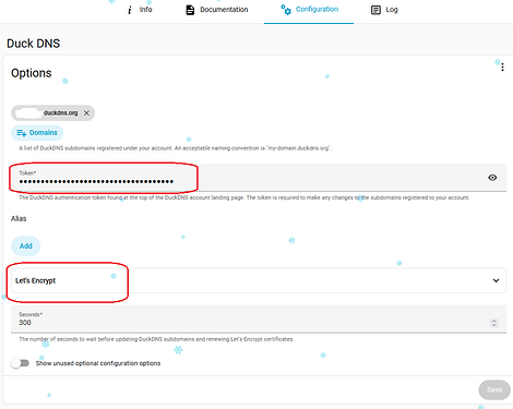

Also make sure you select “Let’s Encrypt” in your “Duck DNS” configuration and using token from duckdns.org account.
