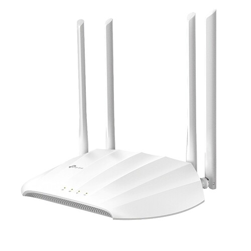

You can however connect your HA Green to a wireless AP running in client mode. This will mean that it’s connected via ethernet but has full access to your guest network. One of these will do, or similar:
Thank you so much for answering that. I will try one of them.
