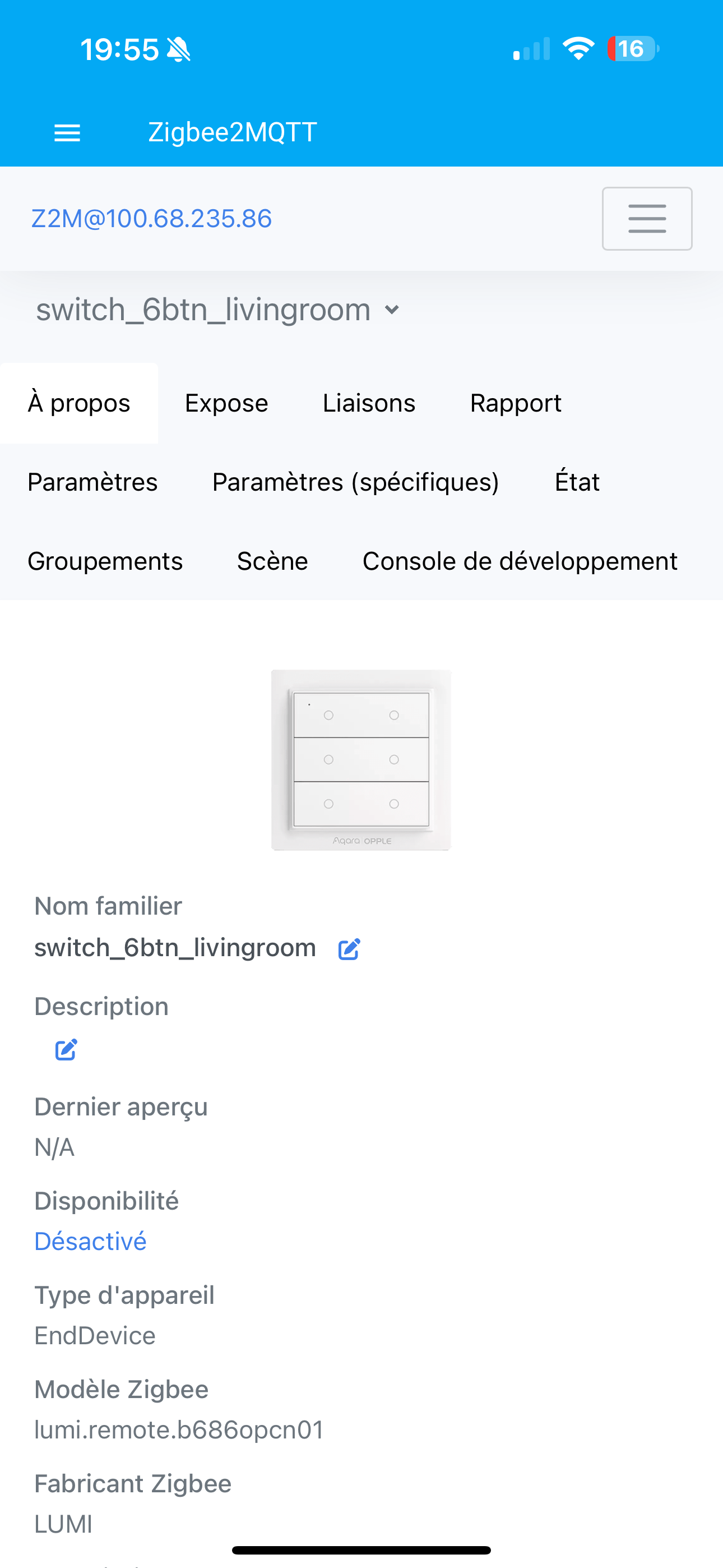

Several button of Aqara Opple wireless switch not available with Z2M
I’ve paired the Aqara Opple wireless switch (Aqara WXCJKG13LM control via MQTT | Zigbee2MQTT )with Z2M but when I try to create a scene, I only see a couple of actions but cannot select several buttons out of the 6.
Any idea what I’m missing ?
I don’t have anything else in the drop down, where I would expect at least single and double actions for each button.
My bad, the switch needed to be put in « event » mode. Once it’s done it allows selecting all the possible actions for each button (single, double, triple, hold, release) :+1:
