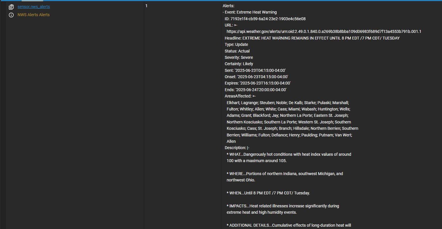

Does this look right? i couldn’t get conversation process to work at all. so trying tts. i think i want to edit this for just all around events like flooding to. but i forget the default value lol. we get mostly storm,tornado and flood watches. i was thinking of filtering his way but i think i’d rather just get all the alerts.
I tried with another zone and got nothing. I get a Error: Error rendering data template: UndefinedError: ā€˜repeat’ is undefined when the script runs
I think the problem is that in the message you are using:
message: The national weather service has issued a {{ repeat.item.description }}
but ā€˜{{ repeat.item.description }}’ doesn’t exist in the context of that script. in order for the script to use a variable is has to be declared in the script itself or passed into it from the automation.
I would guess the script has no idea what ā€˜{{ repeat.item.description }}’ is so it errors out. I think you should be able to see that in your homeassistant.log.
if you want the description in the announcement then you need to send that data as a script variable.

One more bit of spam. So i got it working a lot better. I put the tts directly in to the automation instead of the script. For what ever reason it didn’t want to pass the info on to the script. I kept getting errors of " * Error while executing automation automation.nws_announcements: extra keys not allowed @ data[ā€˜description’]". Soubnds like a templating error and honestly i hate templating with a passion. I was also able to slow it down using ollama and just put in the prompt ā€œTry to talk slowly and not to fast.ā€ and also to keep responses accurate. I’ll create more conditions for other alerts i want to add. i’m sure there is a cleaner way of doing it but sometimes if you don’t have the experience in that area it’s best to do it the way you know lol. As i have learned painfully with HA

I agree. Whatever works. There has been plenty of times I got things working with brute force instead of elegance. :smile:
This is my finished working monstrosity in case anyone wnats to try. i have this option for each alert. i’d like to streamline it for just the alerts i want. but as said before i hate templating. i assume it would be in this field i need to do it just not sure how. One more thing, is there a visual map for the zones? my county is huge and apparently im not in the right zone

as far as the actual alert message it kind of depends on what you mean by ā€œmessageā€.
here is an example of my current alert viewed in the dev tools->states tab:
as you can see in the attributes column there is a lot of different data there that you can use.
so by message do you mean ā€œeventā€, ā€œdescriptionā€ or ā€œinstructionā€?
Thanks. I was referring to the event description.
