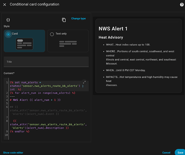

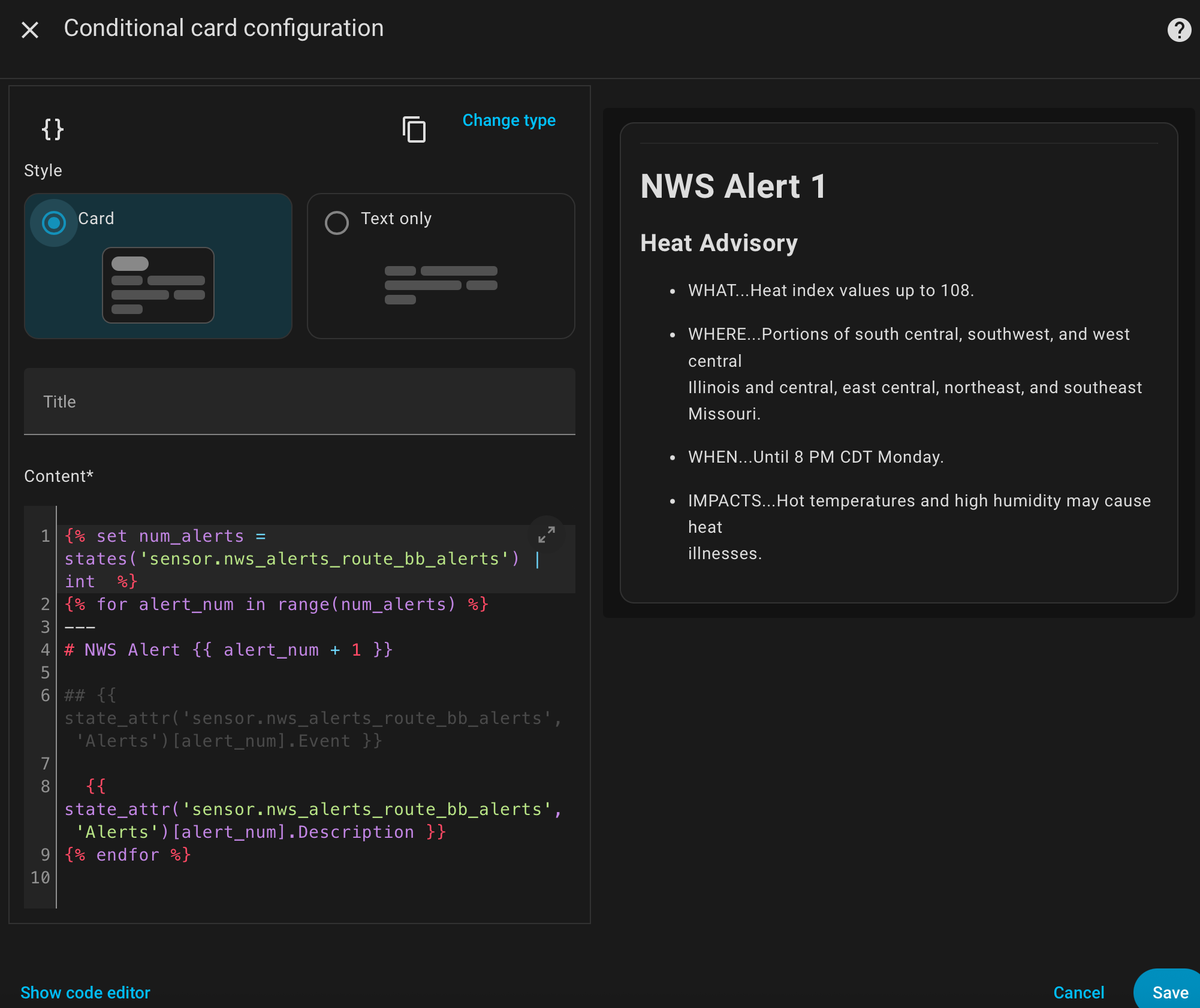

I think so, but some of the code is grayed out and the card doesn’t look quite right, but this kind of code is way over my head beyond copy and paste.
I assume you only have 1 alert at the moment? If so then it looks OK to me.
the template editor does weird things to the colors of text in the left side input section based on what the editor interprets the code to be. if it works as you expect the I wouldn’t worry about the colors. If it didn’t work then the error should be reported in the result section on the right.
ok, thanks. nice work on this integration.

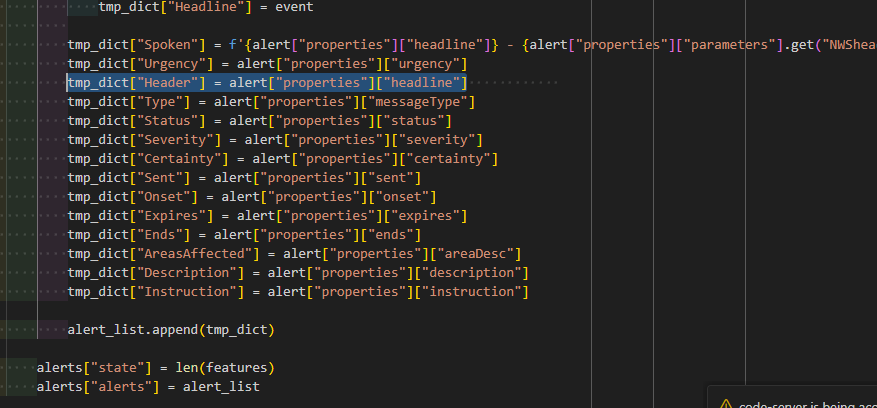

The earlier version (5) inside the init.py I was able to add my own attributes
. I was looking to add this specific headline. Is there any way for me to do this with V6 as I dont see these in the init.py anymore?
Probably.
they are now located in the coordinator.py file
