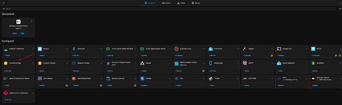

For me it works fine. If you go to HomeKit Bridge and then click the gear icon, you can check bridge and inclusion mode and which devices you want to include/exclude. When I add a new device in HA it shows up in Apple Home too.
Maybe thats the issue it defaulted to accessory rather than bridge. I will give the bridge a try.
I just tried adding it and making sure the homekit bridge was set to bridge with the same result. Nothing when getting close to the lock or tapping.

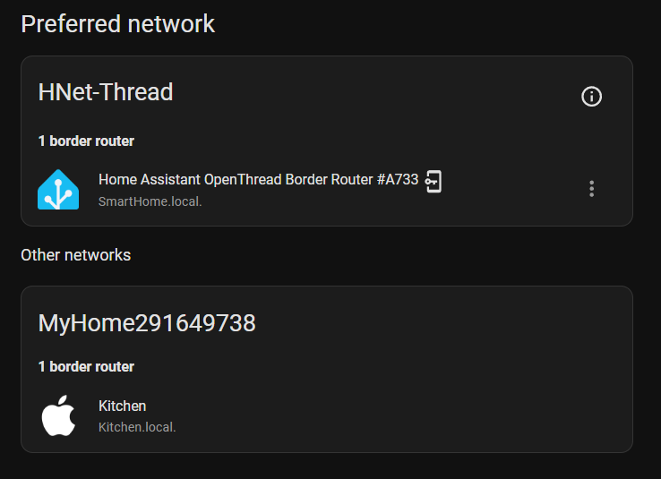

Note that IF this works, since you joined your lock to your HomePod Apple Home, then it’s very likely using your HomePod “MyHome29…” network for its Thread connectivity, NOT your HA network. It also means the Matter pairing process should use the same Thread network, not a different one. This should be fine, as a border router is a router and will happy route to any IP device, but you will have to obtain the MyHome29 TLV if you want to consolidate your OTBR onto the same mesh.

I was able to get this working:
  1. reset the u400
  2. add it as a matter device via the apple homekit thread network (via the iphone)
  3. combine the thread networks in home assistant. This requires you make the apple network your preffered network and then clicking the three dot icon on the ha thread network and selecting combine.
  4. share from the iphone the u400 which gets you a pairing code
  5. go into home assistant and add a matter device select apple home put in the pairing code
  6. done
