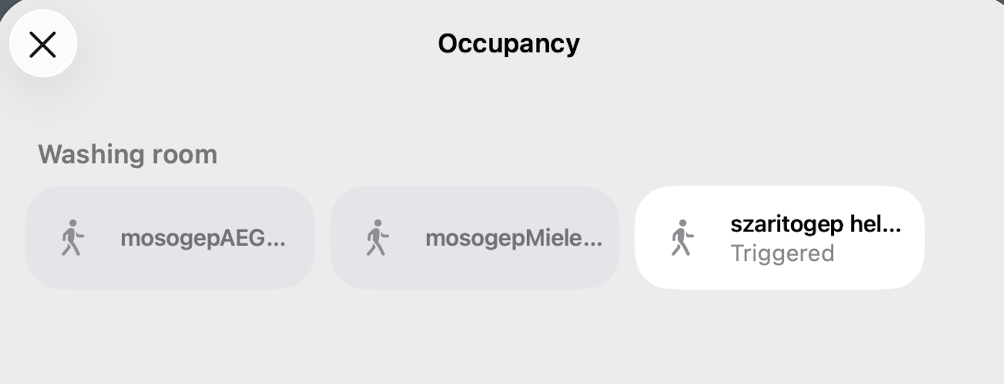

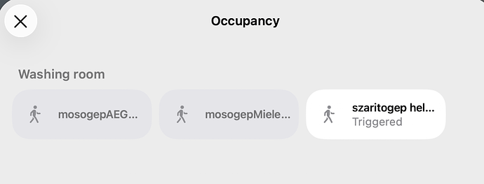

This helper in HA is a binary.sensor / threshold sensor. This sensor shows up in Apple Home as Occupancy sensor… basically not visible in the “room” but as a security sub tab. If I go there then it is visible that the machine “currently RUNNING”.
Here are some pictures how this looks like currently:

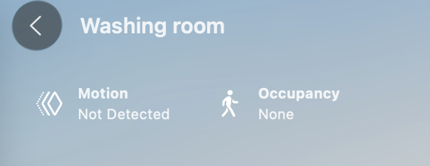

Thank you ! That i found it worked. Yesssss if i select vibration then occupancy remained, but all other it swaps. Currently I keep it as motion. I need to check how this will look like when the dryer is running.
At the end the final solution would be something where I can see each of the 3 devices “status” independent (not needed to go into the submenu) like this:
Honestly, if stupid Apple (or stupid user) would not group all occupancy tiles into this submenu, i would be super happy :smiley:
So far it looks like this:
If all goes bad, i will add a door or smoke or something else (also need to test if there are critical alerts behind it :smiley: so 3 different “sensor” because then it will show up as 3 different entity :smiley: :smiley: :smiley:
