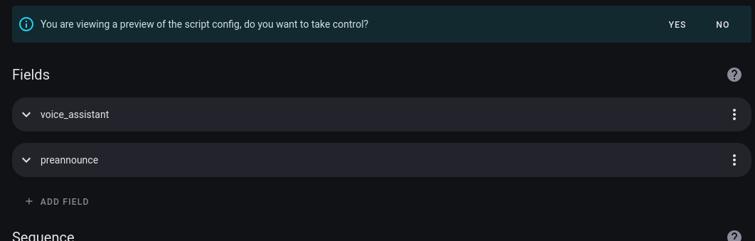

Have any of you had success using the Script Blueprint that was in the 2025.7 release blog? I’m having trouble. I posted a comment in the release blog thread but haven’t had any bites.
I haven’t tried. What errors are you hitting?
I’ve got it here but basically I think we need to pass variables to the script from an automation but it’s not clear to me. When I try to pass data to the script it fails, when I don’t it fails…
@sparkydave if you feel like posting the YAML from your automation, I’m sure we can take a look and see if we can help!
The fields are voice_assistant and preannounce. While it’s a bit kludgy, you can see the blueprint more fleshed out if you open the script in the Script editor then click “Take Control” in the breadcrumbs menu.
Also, when using script.turn_on you should be using variables in data:
action: script.turn_on
  entity_id: script.bedroom_roller_shutters_question
  variables:
    voice_assistant: assist_satellite.home_assistant_voice
    preannounce: false
I know it’s only a screenshot, but it is above. The hard work is done by the script blueprint that came in this months HA release.
Thanks, I’ll give this a test run. It’s disappointing that the team didn’t include these details with the Script Blueprint that was released.
EDIT: test run whilst away from home looks good, no error. I’ll test tonight. Thanks mate
