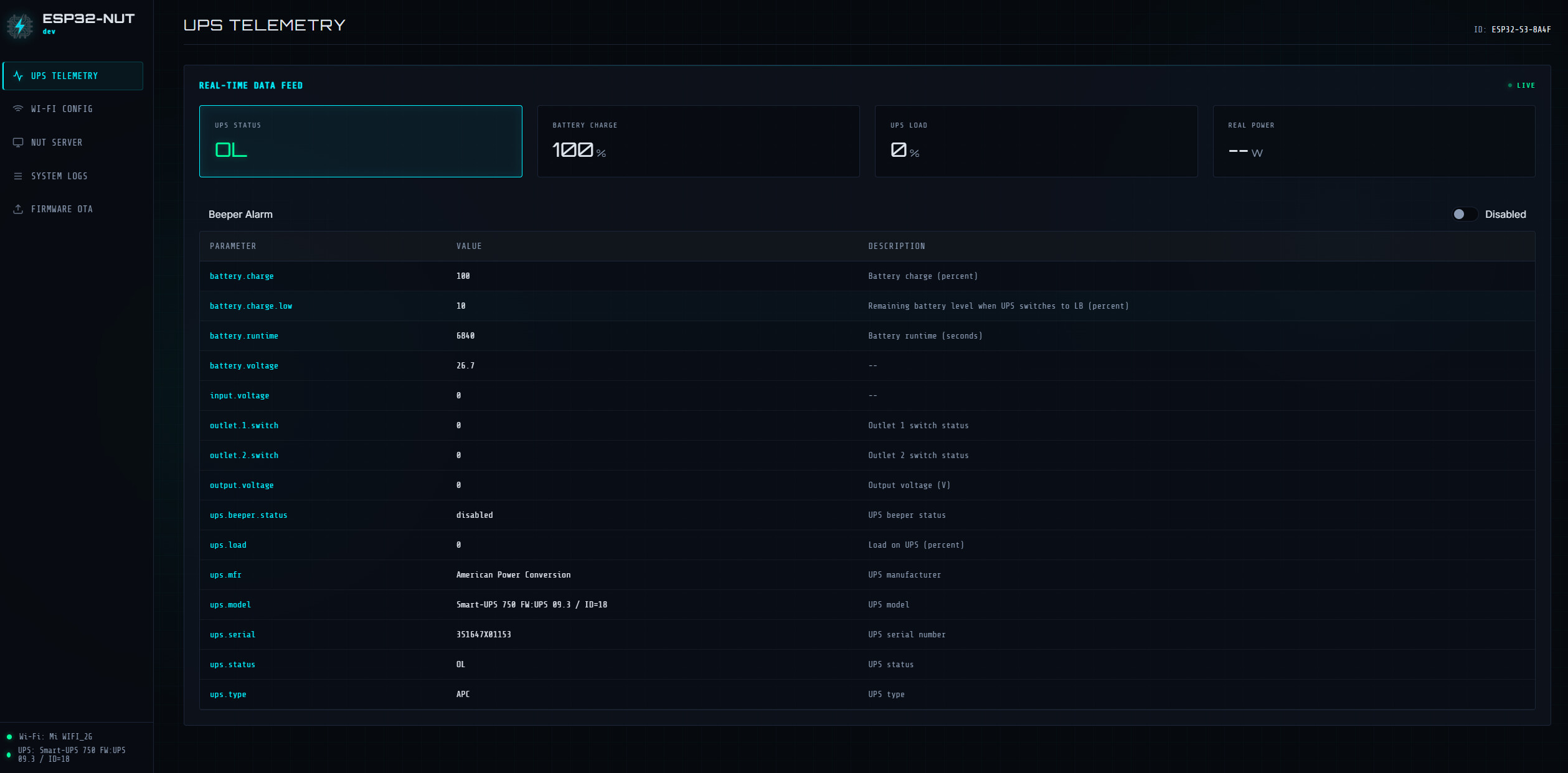

Works like a charm, after some flashing problems. As usual it wouldn’t flash at first. Had to connect USB-power with boot-button held, but then everythink worked without a hickup.
After that the problematic APC BK950MI connected as there had never been any trouble with nut and the USB-connections.
Would be nice to get a LED color guide. My stays red and flashes short on data (I suppose), but I expected it to be green. Was looking for an error for some time until I saw, that on the webinterface everything is green.
