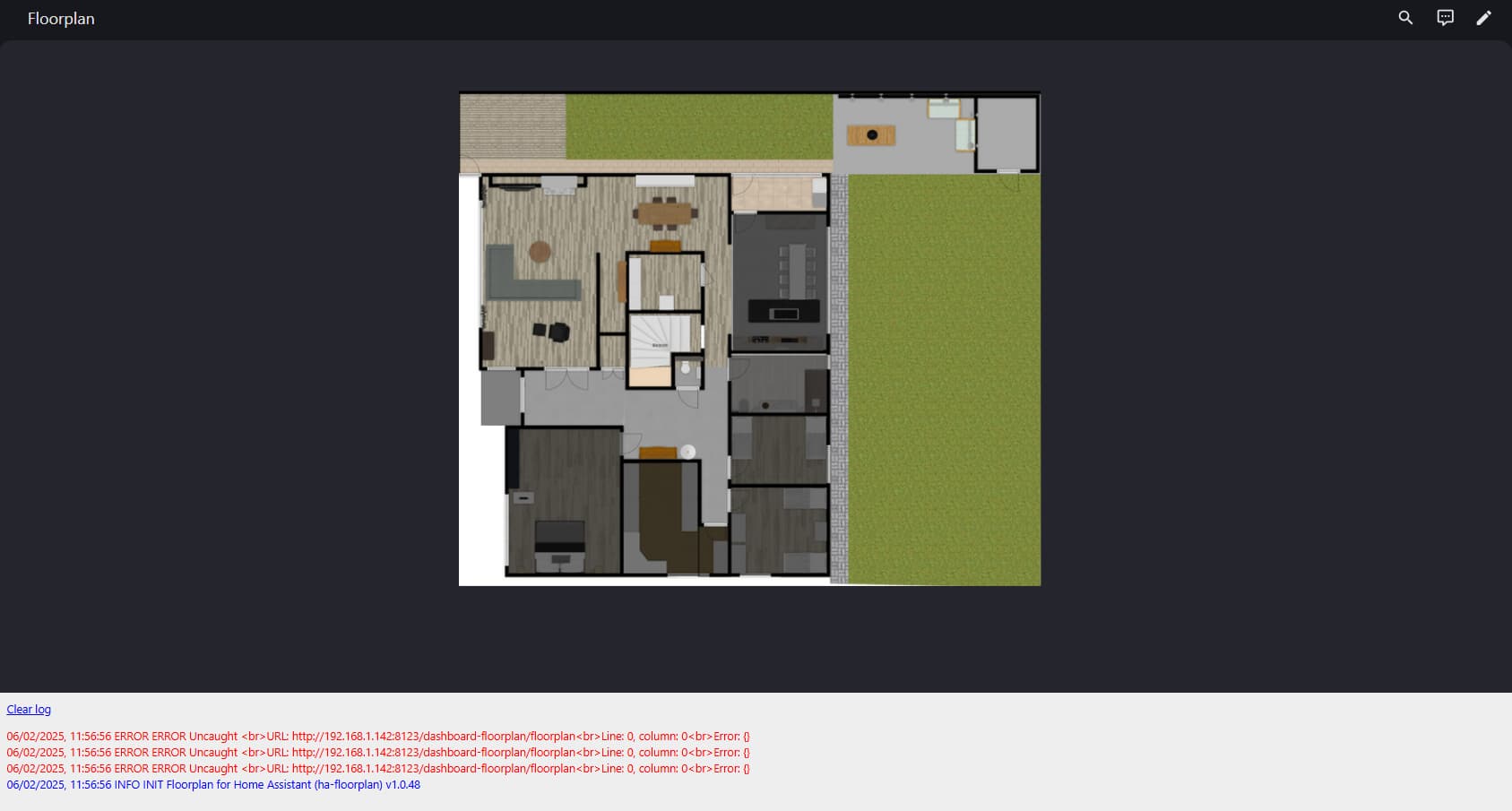

Any idea how i should do a fireplace?
I have the same top view on the floorplan
I would like to have the fireplace light the environment but flicker like a real fire
I can use a gif, but u wont see that from the top… and i wont see light flicker.
Maybe you have an idea?
