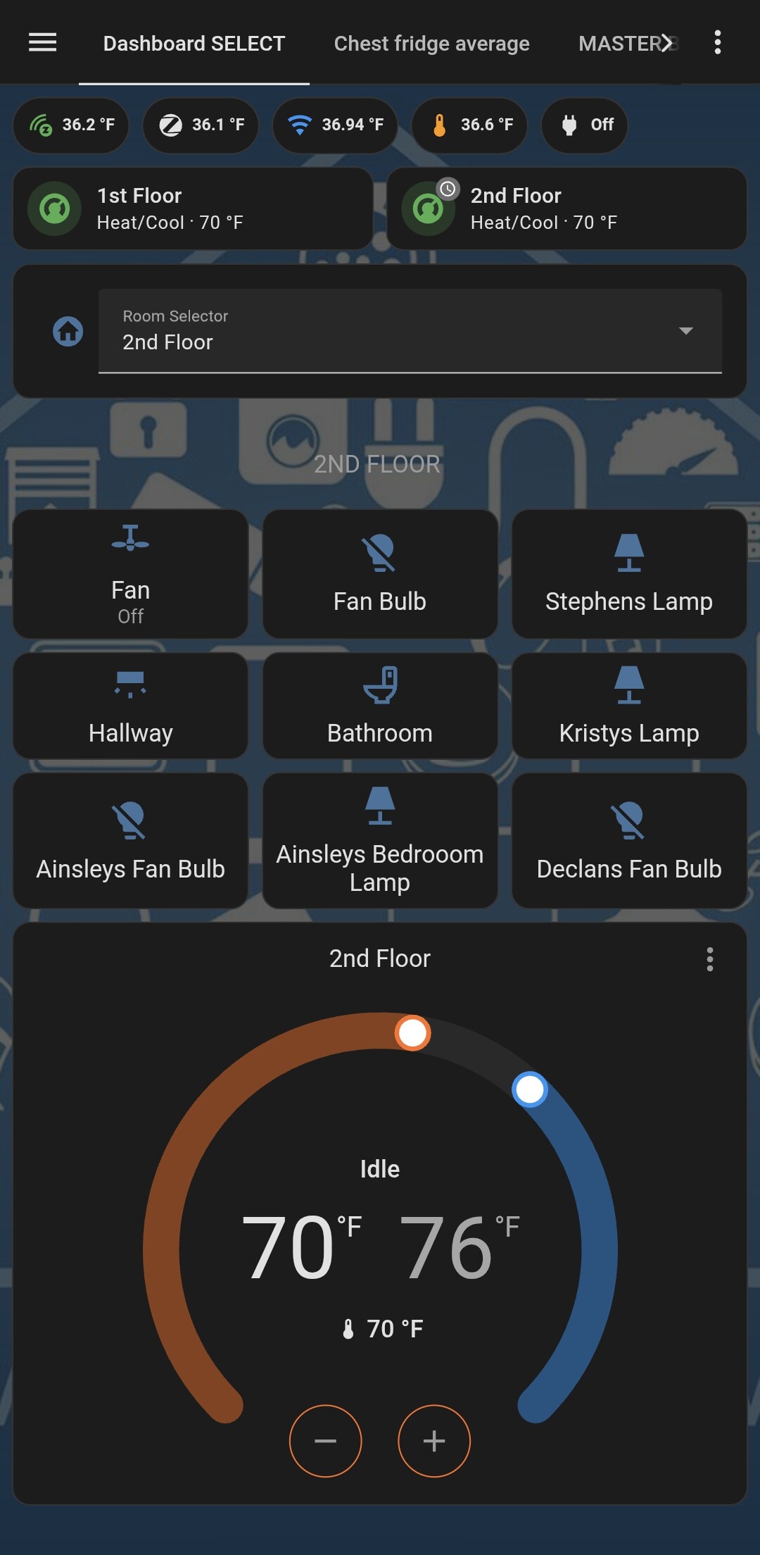

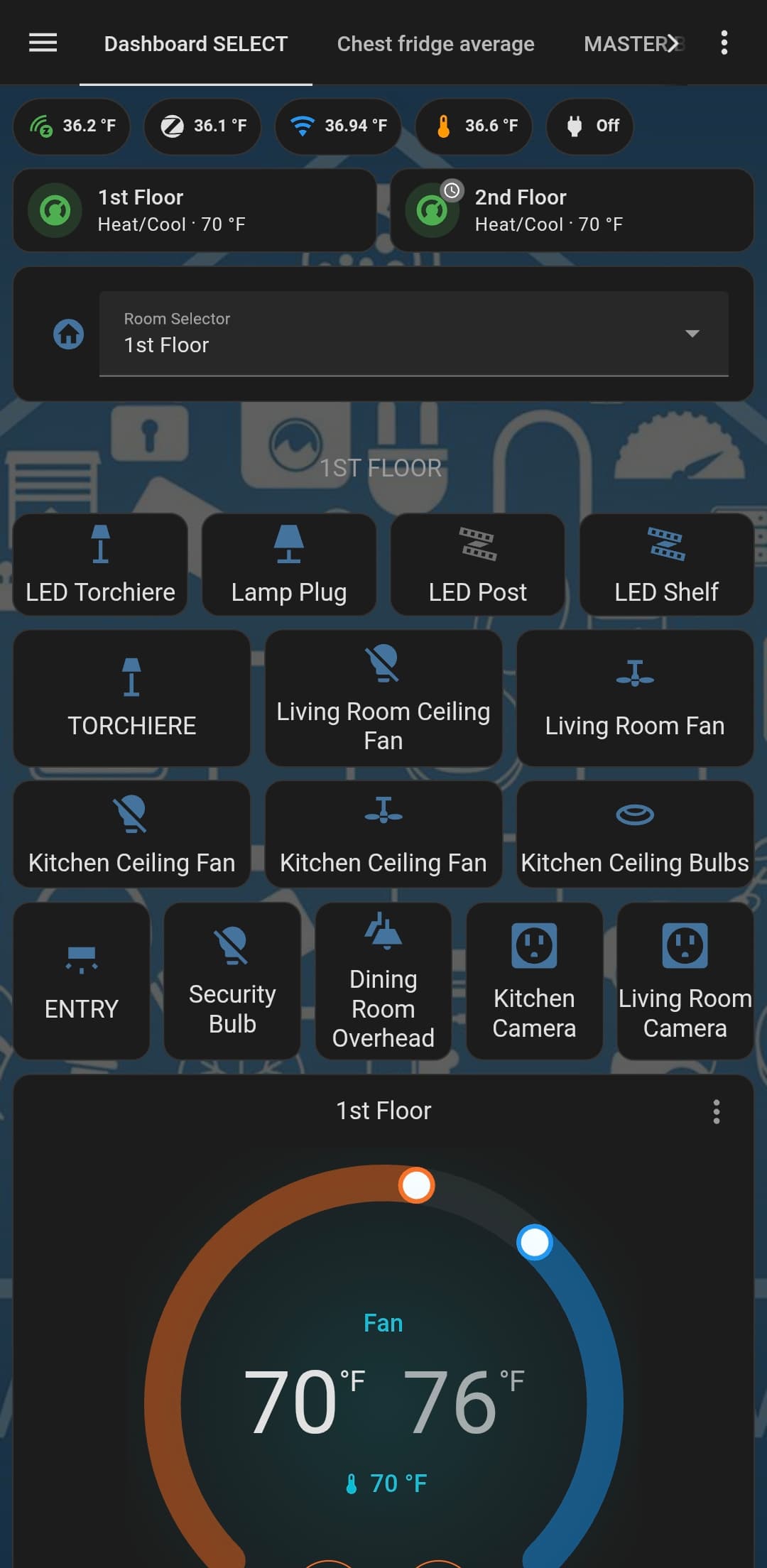

I have a suggestion that is not exactly what you want but might be a workable option.
I have a large dashboard for entire house and have a vertical stack for each floor. I have badges for important things I always want to see across the top and then have a drop-down helper to select the floor. Then, I set the visibility of the floor vertical stacks based on the helper so that when I select 1st floor, the vertical stacks of other floors disappear but top items are always there.
