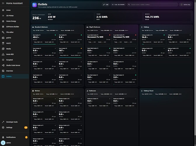

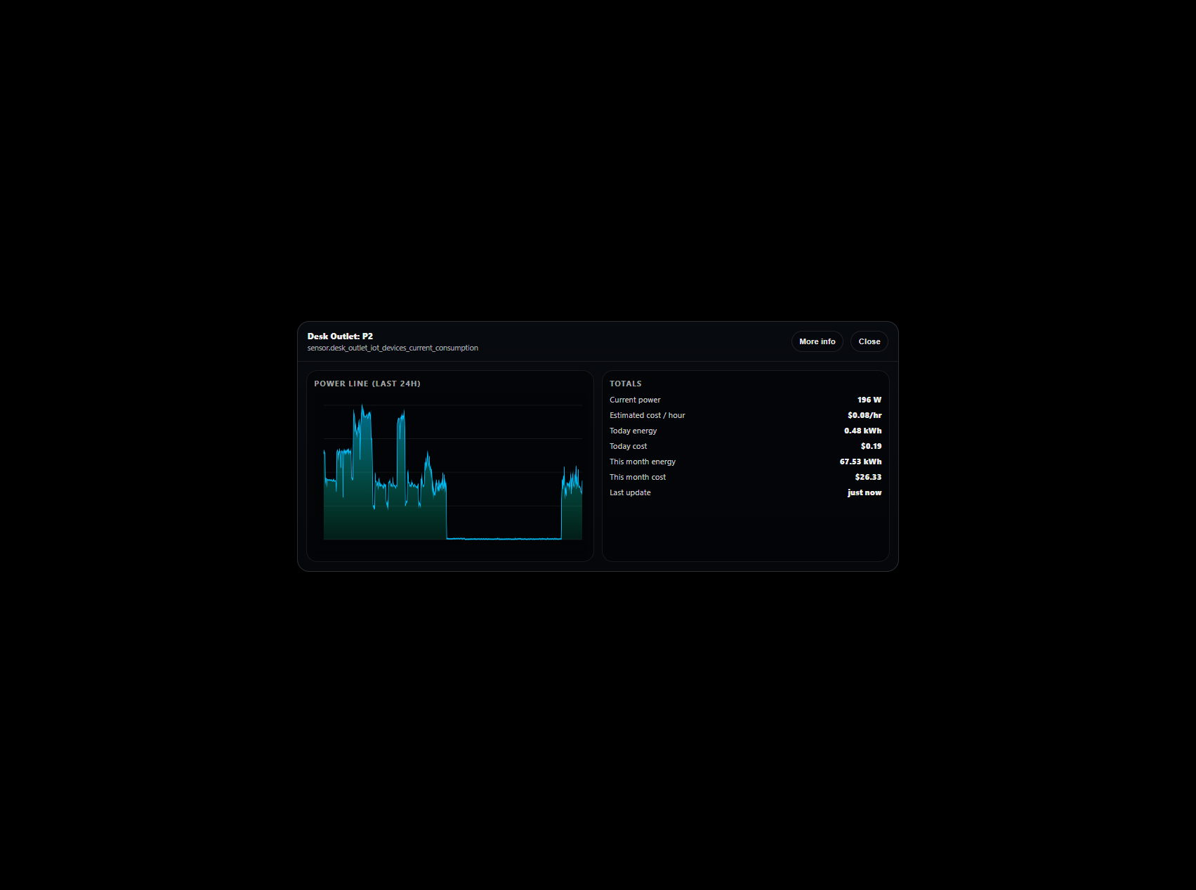

Okay so i got into Java script dashboards a while back to escape yaml/lovlace limiting design and functionality. Im fairly pleased with he results, its a dashboard to monitor all my smart outlets in my home as well as con-ed meter data via op power (con-ed op power is not working the devs have to fix their integration). What the dashboard can do, completely modular user can add room and outlet entities and save them much like a Lovelace dashboard, double click a card brings up a graph with more details, custom analytics, etc.

Screenshots of the dashboard

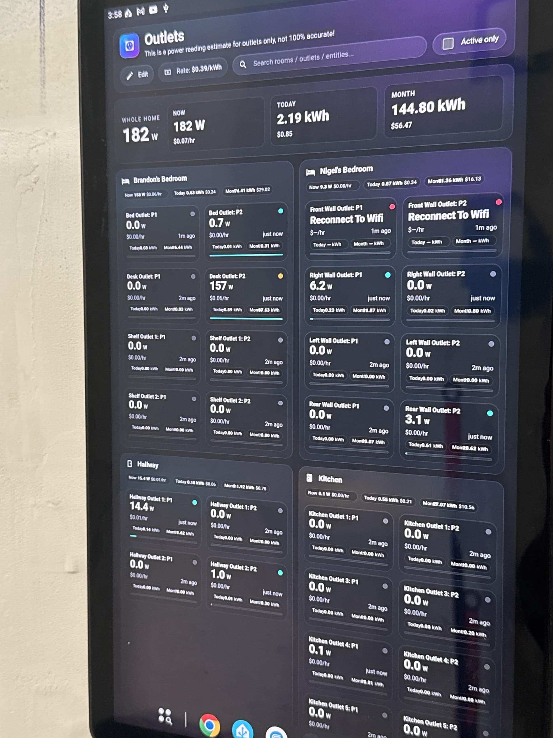

How it appears on wall tablet
