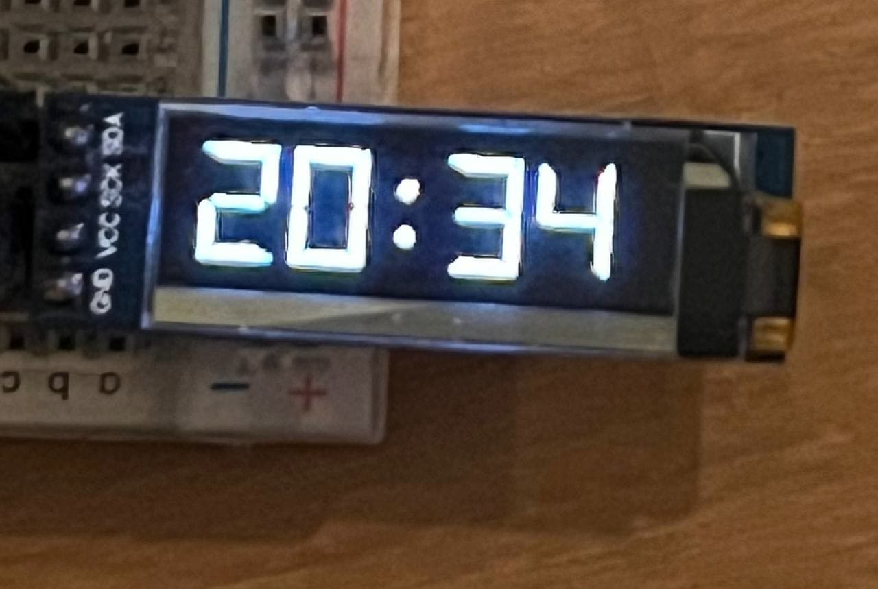

Here’s my setup for an SSD1306 128x32 OLED display:
display:
  - platform: ssd1306_i2c
    model: "SSD1306 128x32"
And here’s the corresponding font configuration:
font:
  - file: "gfonts://Roboto"
  - file: "Segment/DSEG7Modern-Regular.ttf"
