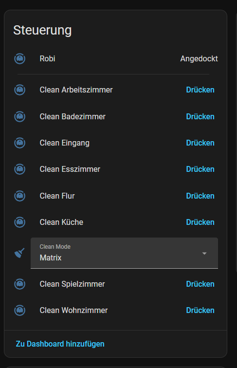

Thanks for this! I’ve set it up and it detected my two Shark vacs.
One of them works perfectly, but on the other (a UR250BE0US), while it can be viewed and directly controlled, no rooms show up or can be addressed by a “clean_room” command.
Do you know if there’s a way to force the bridge to re-poll that data? Or are rooms automatically polled in every update?
Pull the latest, it should be self-correcting.
Yep, updating to latest fixed the problem. Thanks!

Hello, thank you so much for this great opportunity. I’ve managed to get it working so far. Is there a way to choose whether the robot should mop or vacuum?Model:RV282WZEEU
