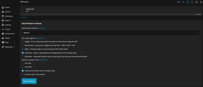

I am using some Shelly 1 PM Gen 4 relays in detached mode (cf. screenshot) to control Zigbee lights via HA. Now I noticed that HA seems to detect a single click event when the lights disconnect (or probably rather re-connect). So my lights toggle uncommanded. I first saw this when the WiFi access points updated their firmware and rebooted in the process, but a manual reboot of the Shellies via their web interface has the same effect.
In my opinion this should not happen, but how can I find out if the issue is with the device (does it actually send the command upon re-connect?) or the Shelly integration in HA (does it misinterpret the re-connect as a single click event?)?

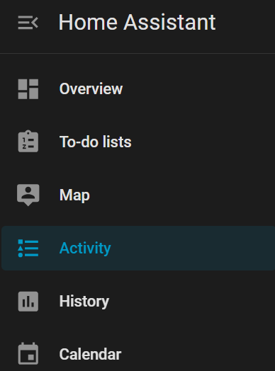

The activity log is found in your dashboard on the left, or on the device page on the right
