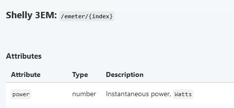

Yeah. You’re right. I missed the {index} when reading the API docs:
Screenshot 2021-09-06 at 22-38-02 Shelly 3EM relay 0 – API Reference
That will be 0,1, or 2 for the three separate phases.
Sorry for misleading you.

Hang on, there is a total of the three phases:
Screenshot 2021-09-06 at 22-53-56 Shelly 3EM settings emeter {index} – API Reference
Without reading more than what you posted…Isn’t that just total POWER?
Right. I’m going to bed before I embarrass myself any further.
NP, :smile: It’s good to have some extra eyes. I might be very wrong myself. Good if someone could confirm what I think.
