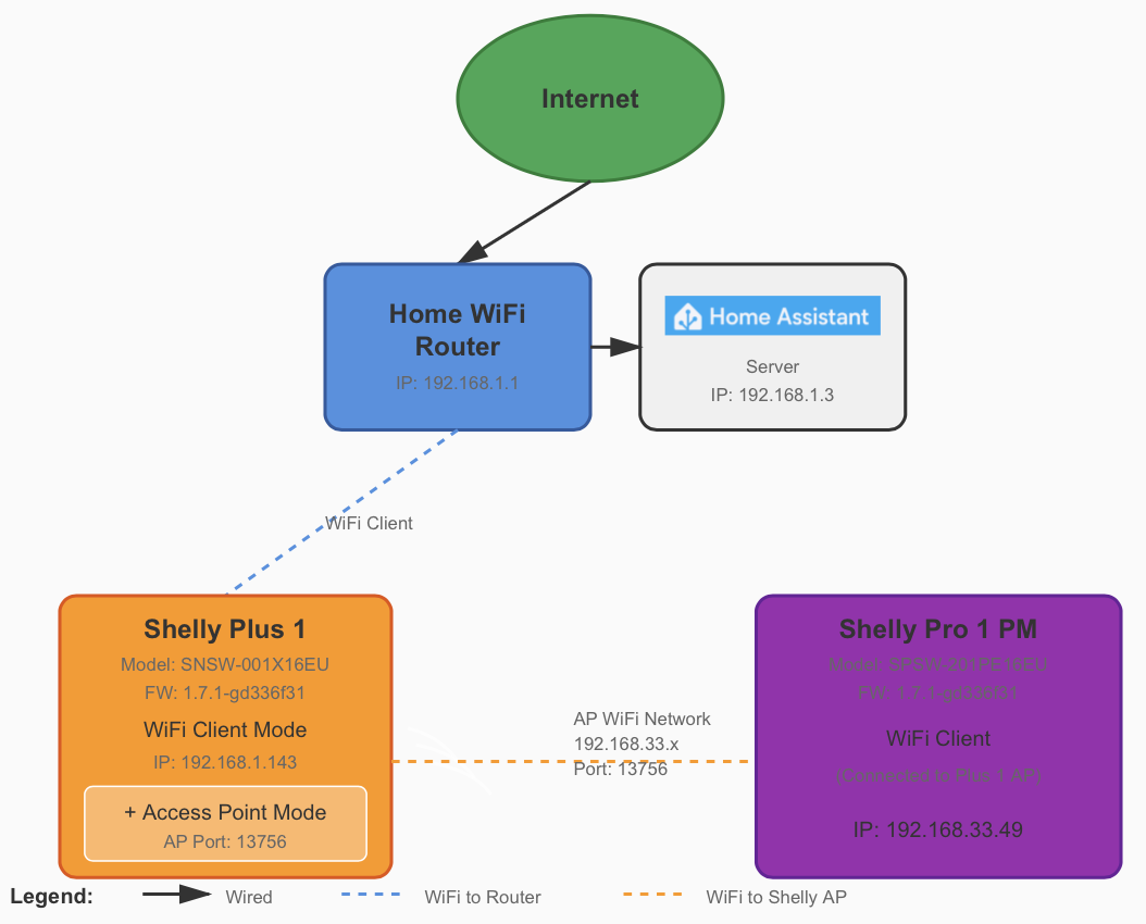

I tried hardcoding the IP address of the client Shelly Pro 1 PM, and lost it. The Access Point - Extender did not want to know about it. Here is a picture describing the one network.

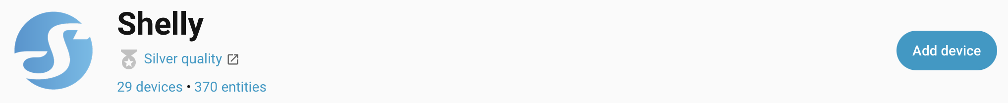

You can configure this device with the Shelly integration using IP 192.168.1.143 and port 13756.
Yes, the Shelly Pro 1 PM client it just out of reach of the normal WiFi, a common scenario for Pro 1 PMs that regularly sit in a metal box which is why Shelly have designed the Access Point and Range Extender function.
That fixed it, thank you.
For anyone with the same issue; there is no need to try to manipulate the client onto the same WiFi network, bridge mode, scripting or hard-coding; use the Shelly Access Point IP address and port 13756 in the HomeAssistant Shelly integration when you hit the “Add device” button.
