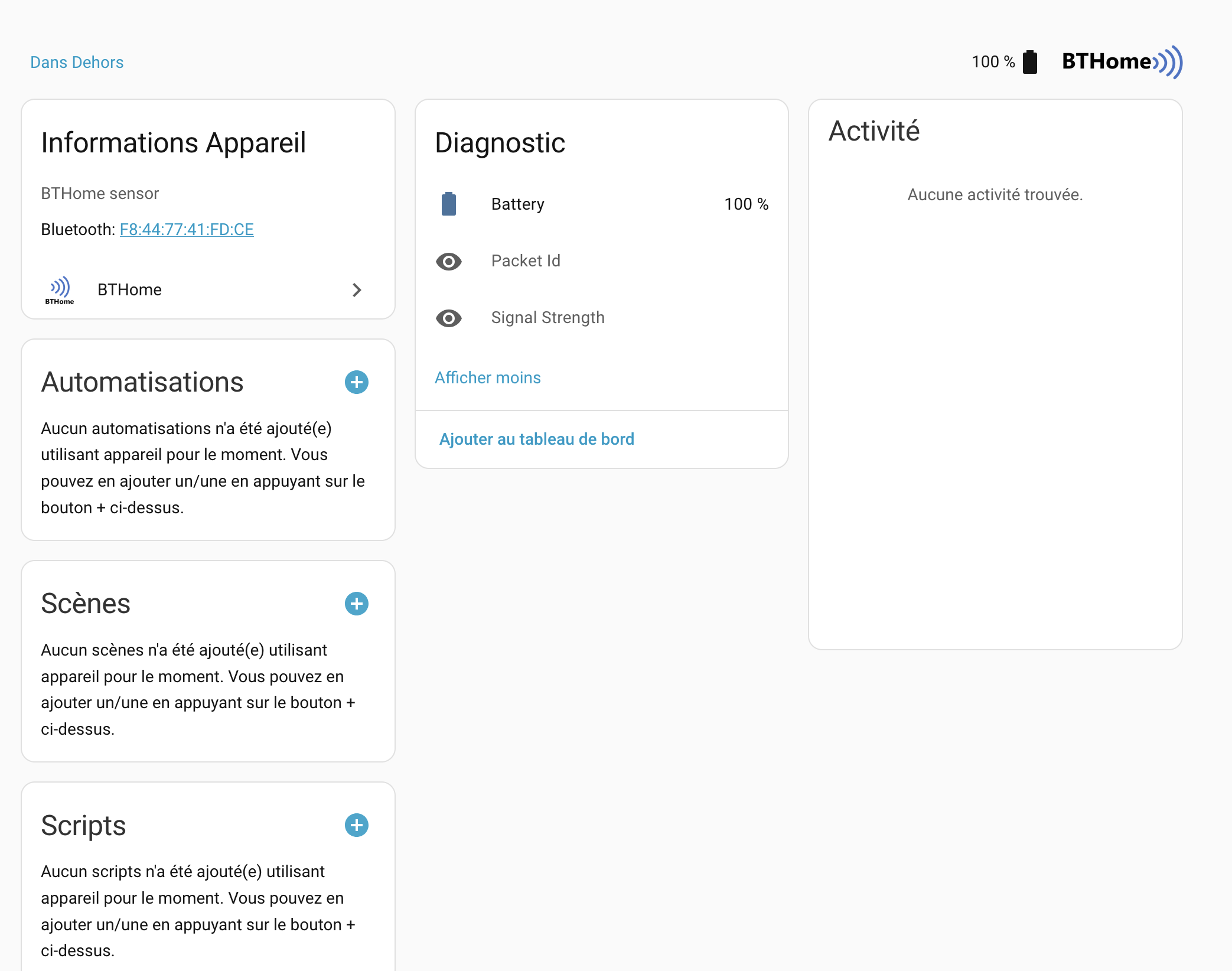

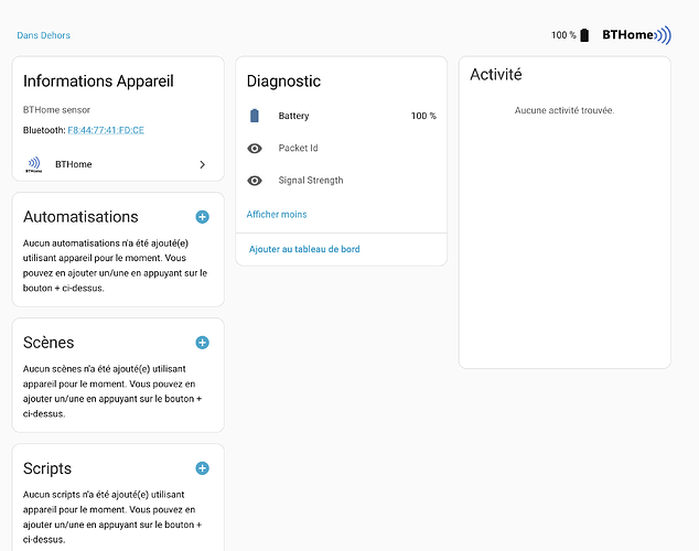

I just bought a Shelly BLU Distance. It doesn’t seems to be totally detected. How can I help ?
Hardware : Shelly BLU Distance – Shelly Europe
Current detection:
Thanks :slight_smile:
Got the solution from Shelly themselves. Have to install Shelly BLU Debug, associate it to the APP/iPhone, then it appears correctly…

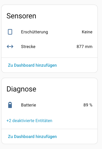

WOW! I am very surprised that NOBODY wrote, what you need todo. This took me almost 8 hours to figure out, and it is very easy if you know, what you require todo.
First you need a bluetooth proxy. You can use the Shelly Gateway (GWF-KZ01) or any other supported adapter. Make sure the Shelly Gateway Firmware is up to date. Next go to Home Assistant > Settings > Integrations > Shelly > Find your Shelly Gateway or add it via IP > Click the gear Icon > Set it to active or passive (passive is read-only).
Next, you will need the BTHome integration (bthome.io) which you can just add in Settings > Integrations > Add Integration. NOW it should automatically find your Shelly BLU Distance if it is in range. It then also shows everything you see in the app.
