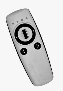

Shelly BLU Remote Control ZB over BTHome : a complete guide
This guide documents integrating the Shelly BLU Remote Control ZB (SBRC-005B) with Home Assistant via the BTHome protocol (Bluetooth Low Energy), without relying on any part of the Shelly ecosystem (app, cloud, gateway). Unlike Zigbee pairing for this device — which is documented on the Home Assistant forum and in Zigbee2MQTT — the Bluetooth/BTHome route currently has no published community write-up. This document fills that gap, based on a real deployment using ESPHome Bluetooth proxies with active GATT.
Hardware prerequisites covered in this guide:
  • Shelly BLU Remote Control ZB (SBRC-005B), in BTHome mode (not Zigbee)
  • At least one ESPHome Bluetooth proxy in range (a Shelly Gen2+ in passive mode also works, with limitations — see below)

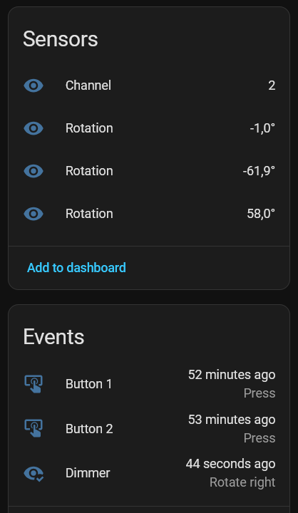

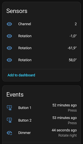

The entities exposed by the device
Once added, the device exposes 7 entities:
Entity Domain Role
event.shelly_remote_button_1 event Button 1
event.shelly_remote_button_2 event Button 2
event.shelly_remote_dimmer event Scroll wheel (rotation)
sensor.shelly_remote_channel sensor Active channel (0 to 3)
sensor.shelly_remote_rotation sensor Magic Wand angle, X axis (degrees) — see dedicated chapter
sensor.shelly_remote_rotation_2 sensor Magic Wand angle, Y axis (degrees) — see dedicated chapter
sensor.shelly_remote_rotation_3 sensor Magic Wand angle, Z axis (degrees) — see dedicated chapter

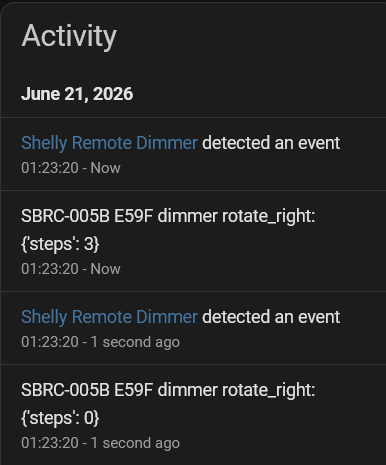

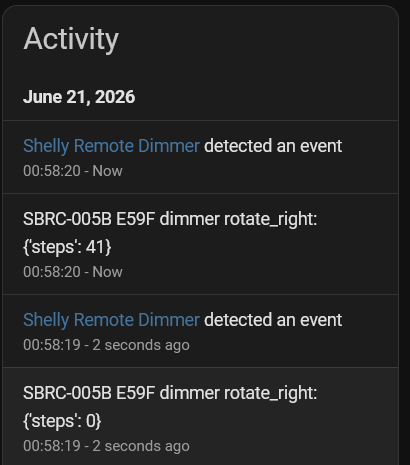

The dimmer's real-world behavior (captured live)
Watching the device's logbook in real conditions:
Short roll (one notch):
  SBRC-005B E59F dimmer rotate_right: {'steps': 0}   ← "ping" event, to be ignored
  SBRC-005B E59F dimmer rotate_right: {'steps': 2}   ← useful event, gesture magnitude
Long roll:
  SBRC-005B E59F dimmer rotate_right: {'steps': 31}  ← useful event, gesture magnitude
The first event consistently has steps: 0 — a protocol artifact with no usable value. The second carries the actual gesture magnitude (steps), proportional to how fast/long the wheel was rolled.
Timing of the two events: the first event (steps: 0) fires the moment you start moving the wheel. The second event (steps: N) fires the moment you stop moving the wheel — not at a fixed interval. If you keep scrolling for 4 seconds, the second event arrives roughly 4 seconds after the first one. This matters for automation design: there is no fixed delay to rely on, and a "wait" pattern based on a timeout would either fire too early on a long roll or waste time on a short one. The approach below sidesteps this entirely by reacting only to the second event, whenever it arrives.

"Long press [on channel button]: Starts angle measurement using the built-in accelerometer. Upon release, the rotation angle is transmitted in the X, Y, and Z axes — one angle per axis."
In practice, this surfaces as three additional sensor entities on the device, on top of the four already covered:
Entity Domain Role
sensor.shelly_remote_rotation sensor Rotation angle, X axis (degrees)
sensor.shelly_remote_rotation_2 sensor Rotation angle, Y axis (degrees)
sensor.shelly_remote_rotation_3 sensor Rotation angle, Z axis (degrees)
Triggering a long press on the channel button and then physically tilting/rotating the remote produces values like these (captured live):
Channel: 2
Rotation: -1,0°
Rotation: -61,9°
Rotation: 58,0°
Each of the three sensors reports a signed angle, presumably relative to the remote's resting orientation at the moment the long press started — consistent with a per-axis accelerometer reading taken on release, as described in Shelly's documentation.
Status: not explored, not used
This guide does not cover how to build automations from these three sensors. They are documented here for completeness but no gesture-based automation has been built or tested against them as part of this write-up.
