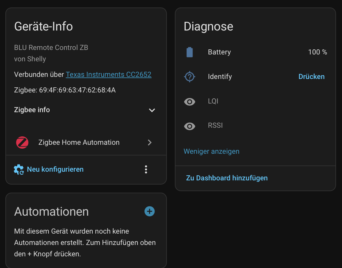

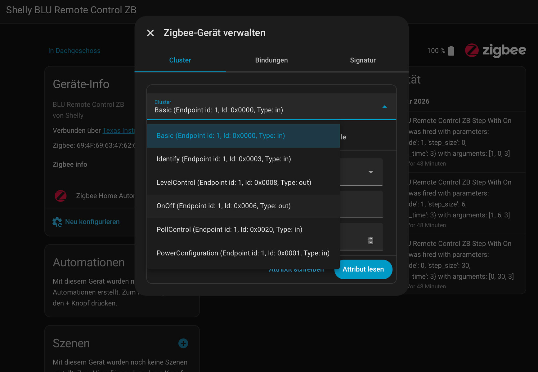

Hi! I have a Shelly BLU Remote and try to integrate it in Home Assistant via Zigbee. I am using a Smartlight SLZB06U Zigbee Adapter.
I can add the Zigbee device, but the Remote has several Buttons and I am only getting 2 entities?
I do get some “Attributes” via the management option, but i dont know if this can be used? I was hoping for normal entities for the remote buttons…

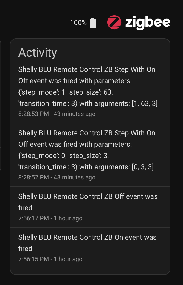

Buttons don’t create entities - they create events.
You can see them in the Actions section on the right side of the screen in your screenshot

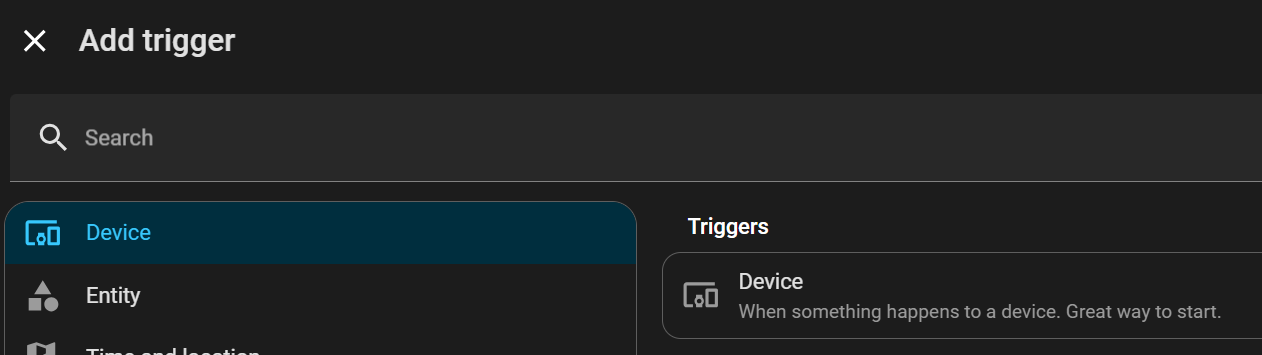

Once you do that, create a new Automation & select the Device Trigger:

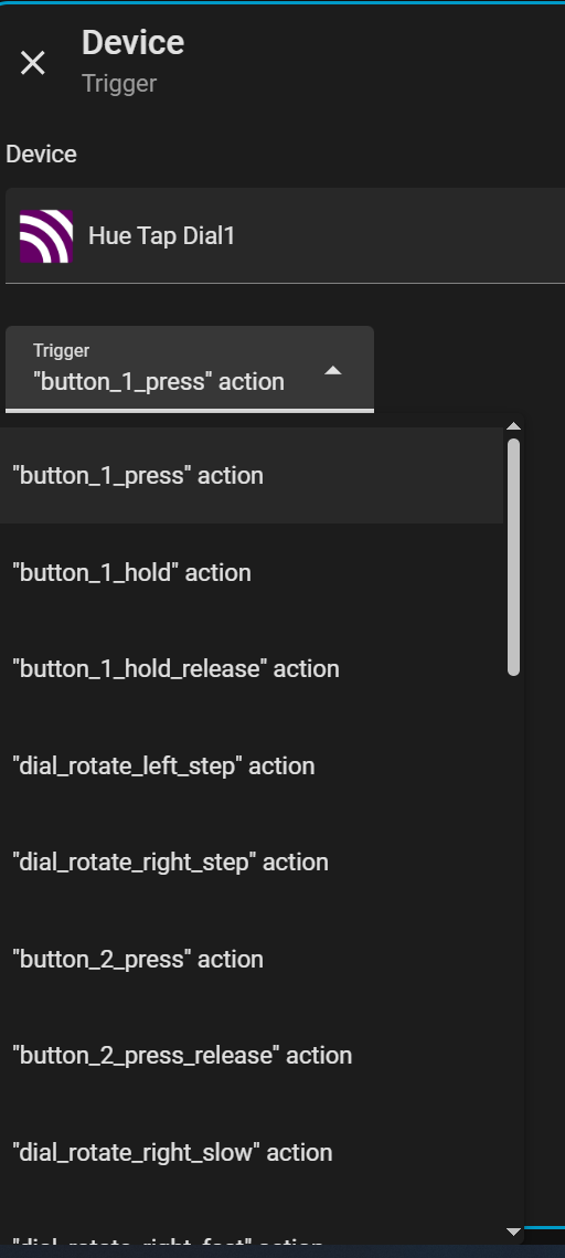

Once you pick the Shelly Remote, you should see all those actions available in the dropdown. I’m using my Hue Dial in the screenshot below, just to give you an idea.
Create an automation using a single trigger & have it do something simple, like turning on/off a light. Save & test it. If it works, go back into the automation and edit the trigger to use a different action. Keep repeating for all actions until you’re happy everything is working.

I do see the actions from the remote, but how can i record them and use them as triggers? If i select the remote in the automations dialogue, it shows only 2 options?

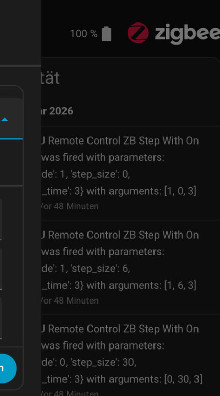

They should have shown up automatically. Restart HA & check again just in case, but if they still don’t show up, you’re gonna have to use event triggers, which requires some advanced knowledge.
Basically, you’ll have to read through [this] (Developer tools - Home Assistant) & listen for each zha_event (follow the steps in the screenshot here).
