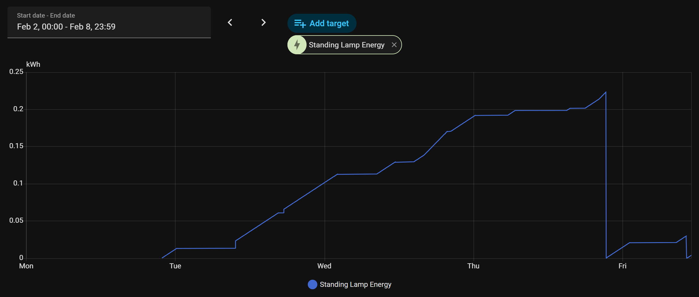

i have multiple Shelly Duo bulbs in my home. Some of them and always on and some of them are switched on lamp button so they go offline.
The problem I have with all of these is that the energy consumption sort of resets and goes to zero each time the bulb loose power. So every time the bulb is turned on and get power, connect to wifi and i start with 0KWh in stats of energy for those bulbs. This way i am not able to track total Energy consumption in HA. It like HA is not saving energy usage and start over again when device get electricity.
Other Shelly devices like smart switches, plugs or blinds controllers show their KWh increasingly all the time so it seems to be only Shelly Duo issue.
I am attaching graph how it looks like:
Is there anything i can do to force HA to remember how many KWh was used by those devices so i could track total consuption?

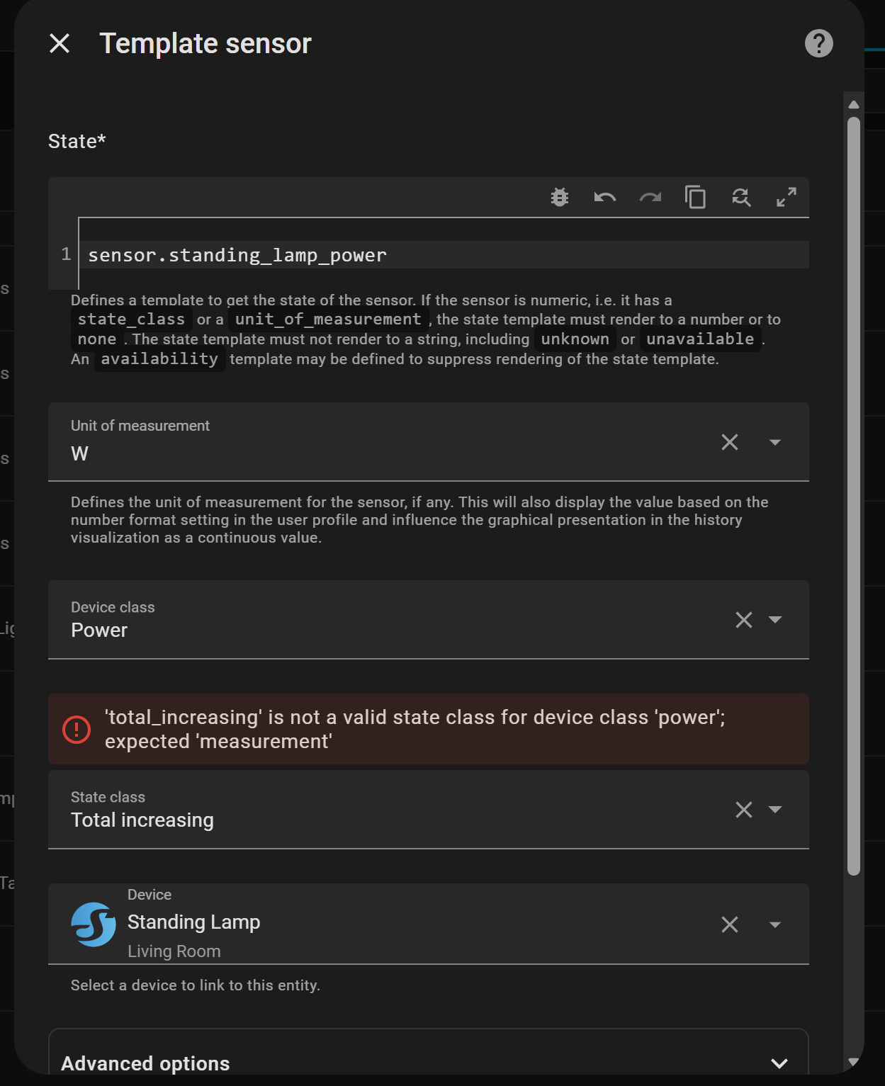

However I am missing something. My understanding is that i am creating here virtual sensor. I thought it will be converting Power (W) to Energy (kWh) but i get info that power cannot be total increasing class:

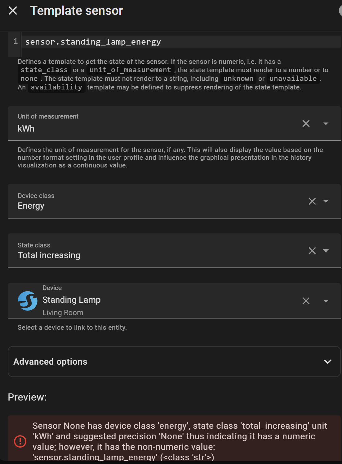

When i do Energy as total increasing (which i don’t understand how it would add up in that virutal sensor as it zeros everytime it looses power but perhaps there is mathematical way to do that) then i get error like this:

You can convert power to energy using integral sensors. Such created energy sensor will be total_increasing. Yes, it’s the way.
I suggested to create helper teplate sensor out of existing energy sensor. But ensure that new template sensor state class is total_increasing. In gui it might be called differently (like reset zero or something like this)

Yes, so i think in the second screenshot i am trying to create the template sensor based on existing energy sensor of my lamp. However the error which i don’t understand is preventing me from get it to work. As you can see on the screenshot state class is total increasing.
Why do you think it’s not total_increasing? I have a shelly plug and it has also such sensor and it is total_increasing.

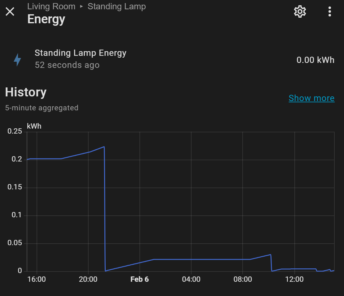

I think the assumption may be on screnshots from my 1st post where graphs going to 0 after restart.
Yes on the “individual devices total usage” it is increasing. But this show only last 24h. When i click from there on my lamp i get graph like this:
Where kWh being resset to 0 after each restart so for tracking historical data it seem to be imposible.
But that’s what total_increasing class allows AFAIK.This is normal. Resetting to zero are allowed, the sensor cannot go down to any other value though.
