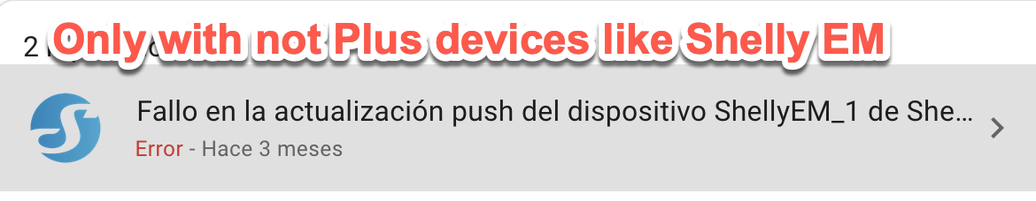

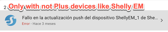

With this rule I can add my shelly devices to HomeAssistant without problems, I can ping them and integration seems to be working well except with old Shelly devices.
Also with plus devices I’m having some eventual disconnect problems.

Regarding Gen2 devices seems that the only problem in HA is random disconnects but it reconnects automatically, I cannot see any error or alert in HA.
