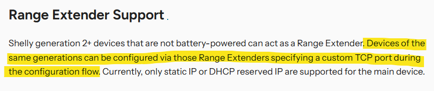

I have a Shelly 1PM gen3 running at the net AP / Range Extender of another Shelly pm mini gen3.
The Shelly 1PM can be accessed in the local network via AP-IP + Port.
But I do not manage to integrate this Shelly into Home Assistant (“unavailable”).
Checking via Google I found some information, that this configuration is not possible in Home Asistant, basically.
Is that correct?
Thanks
Werner
Have you read the documentation? Shelly - Home Assistant
Yes, I did. But I cound not find relations to my problem concerning Home Assistant.
Do you have any idea?
Thanks.
Werner
Really?
