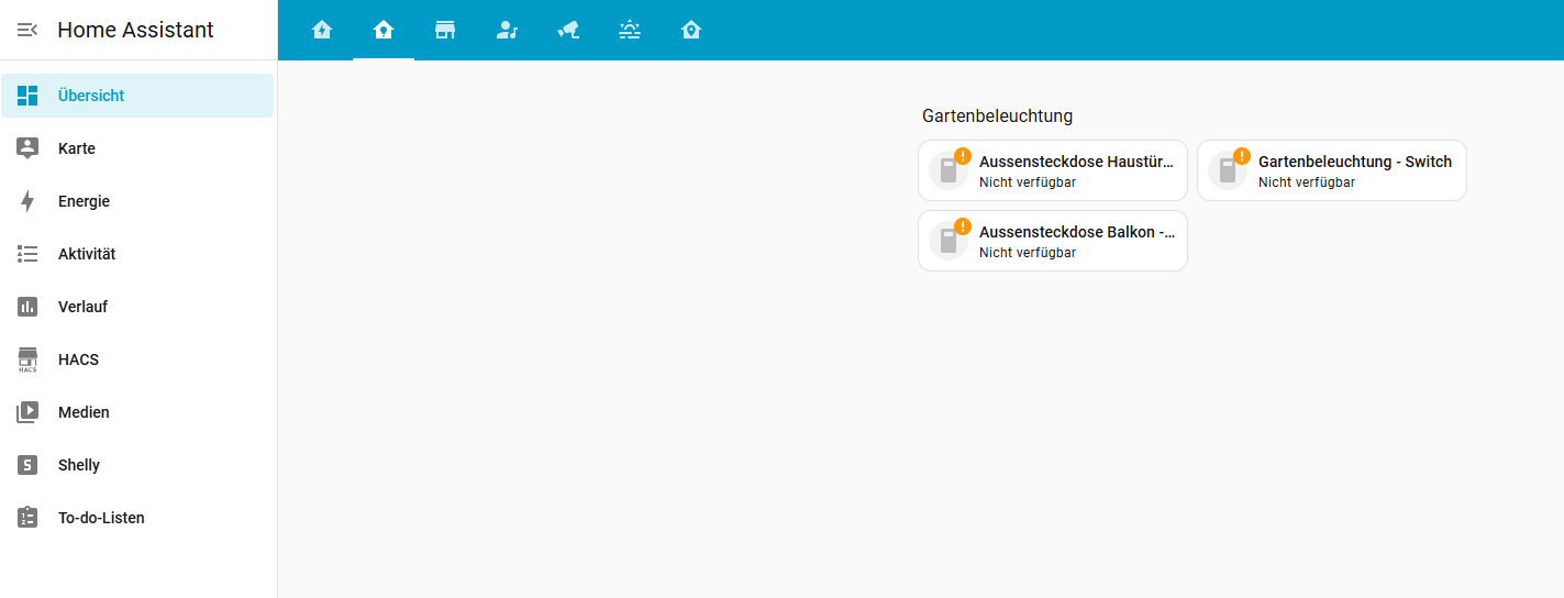

Ok, when I restart the HA, it looks like this on the dashboard:

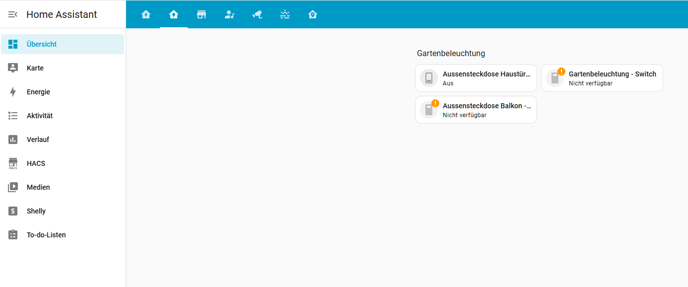

After restarting the device in the Shelly console it looks like this:

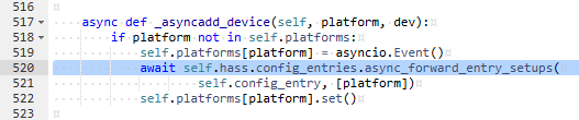

In the log file I find the following entry:
“Detected that custom integration ‘shelly’ calls async_forward_entry_setups for integration shelly with title: Shelly and entry_id: 01K63ZX7MHN2G7XSAM5RPMHGDB, during setup without awaiting async_forward_entry_setups, which can cause the setup lock to be released before the setup is done at custom_components/shelly/init.py, line 520: await self.hass.config_entries.async_forward_entry_setups(. This will stop working in Home Assistant 2025.1, please report it to the author of the ‘shelly’ custom integration”
The following entries are on line 520:
Do you have any idea where I should look for the error or how I can fix it?

Sounds like you’re using the deprecated custom integration instead of the core integration?
Yes, it looks like you’re right.
Do I have to delete the integration entries and then delete Shelly in HACS?
Will the Shelly devices then be automatically discovered in the core application? I’m a bit concerned, not that I’m making a big mistake.
Yes they will.
Great, thank you very much. That was the solution, now everything works as expected. Thanks for your help.
