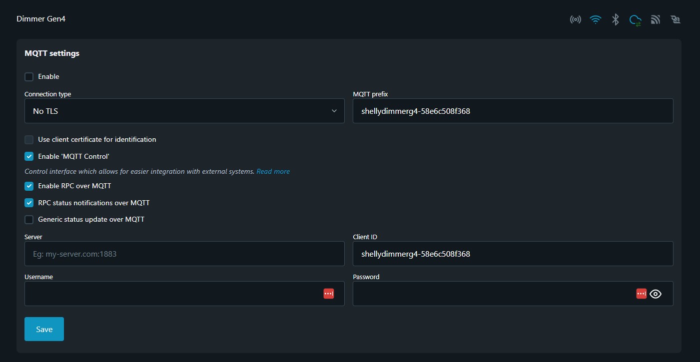

I’ve just installed a new Gen 4 Shelly dimmer as part of my bathroom upgrade. Howver I am having problems pairing the device with Zigbee2mqtt. It finds the device but loads an automatically generated profile.
I know the device is supported by z2m and the notes on the page here suggest pairing via Wi-Fi and the Shelly App and then upgrading the firmware.
I have done this and installed the latest firmware, however trying to pair with z2m results in failure. I can access the web interface on my Wi-Fi network and notice there is a configuration page for mqtt settings.
Should I enable these settings and what should I choose for the connection type and do I need to enter the HA mqtt server details with username and password.
I had assumed, perhaps incorrectly, the device would be added automatically on discovery by z2m like any other zigbee device?
