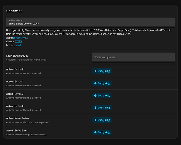

If you are using the awesome ShellyElevate app on your Shelly Wall Display (like the XL version) to run Home Assistant dashboards locally, you might want an easy way to map all the hardware buttons and swipe gestures to Home Assistant actions.
This blueprint listens directly to the native MQTT topics published by the ShellyElevate app. It allows you to assign actions to all available inputs (Button 0-3, Power Button, and Swipe Event) in one single automation, just by selecting your Shelly device from a dropdown menu!
:glowing_star: Features:
  • One-click device selection: Just select your Shelly Wall Display device from the MQTT integration list. No need to look for individual event entities.
  • All inputs in one place: Assign specific actions to Button 0, Button 1, Button 2, Button 3, the Power Button, and the Swipe Event.
  • Instant execution: It fires the action immediately on any press (executing immediately upon receiving the MQTT message).
:clipboard: Prerequisites:
  • A Shelly Wall Display (e.g., Wall Display XL).
  • The ShellyElevate addon installed on the display with the MQTT connection enabled.
  • Home Assistant MQTT integration up and running.
:inbox_tray: Import Blueprint:
Direct Gist Link: Shelly Elevate Device Blueprints
:poland:Pod linkiem jest dostępna również wersja polska
:poland:Polish version available too
Enjoy!
