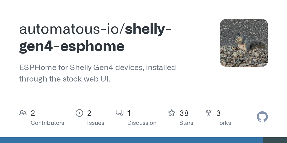

For Gen4, you could probably try this project:
I could try to reverse the fw on a Gen3 device and see if I could send you a test file but I am just not too confident.
the responsibility is on me.
thanks for the link, i will give it a try!
